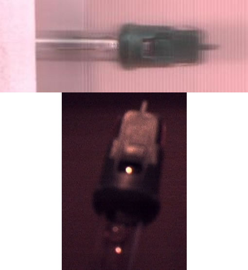

I need to get spare FUSE bulbs for the following, but no one seems to stock them. Anyone know anywhere in the UK that does?

I would be happy to use a 12V bulb but the problem i'm having when trying to get them is that nobody sells this specific fitting. See image below.

Re: Fuse bulbs
It looks like a fairly standard christmas tree light fitting, you may be able to get replacements at a lighting outlet - although you will probably have to ask.
But probably the first place to look is where you bought them from, they should be able to help you - either by sourcing the bulbs for you, or giving you details of where you can get them from.

I don't know how it's done there in the UK, but over here, we just use a replacement bulb with the right specs and swap it into the plastic base. The replacement bulbs themselves have no bases -- they are simply wire terminal type bulbs similar to the ones shown here, except that they are about 20mm long with a pointed tip to the envelope. We simply straighten the wire terminals on the dead bulb and pull it from the base. The new bulb gets slid into the base, with its wire terminals aligned with the holes in the base. Bend the wires over the base to complete the swap.
In that way, the base style becomes irrelevant -- all that matters is the actual bulb specs.
