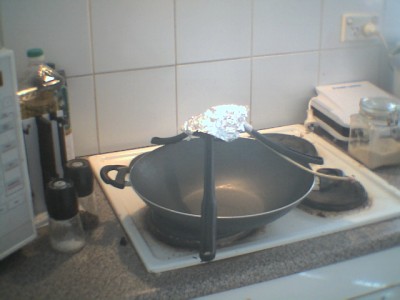

What about using a wok or the lid for a wok
Well Any Reflector is Better than Nothing, MOST are Almost Useless. This would Include A Lid from a Wok.
A Parabolic is a VERY UNIQUE Shape. All Sounds coming in from a Direct Frontal direction are focused to one specific point, (Focal Point) thus Amplifing that Signal.

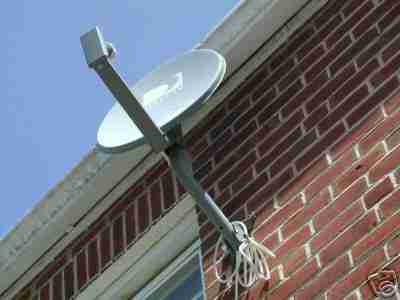

Addendum...I was curious as to the Direct TV dish I no longer use.I took a tape measure and I got a 20" diameter from top to bottom.Will this be good to experiment?I figure the focal point is where the LNB is currently mounted,but I will have to play with that.
SC
You mean like this??

Almost...here is the dish I'm talikng about.I want to use the existing arm where the LNB is connected to use as my microphone mount.I was wondering if the parabola is a good shape.
No, because it's an offset dish - if you've got one you could try it, but I doubt it would perform very well?.
