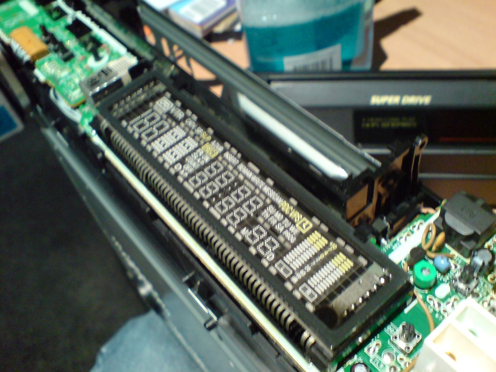

So I downloaded the service manual, and got it all dissasembled, the screen seems to be made of a thick glass piece (LCD?), there is no LED or Globes I could find that might be responsible for illuminating the display. As I inspected the unit, I noticed a large black spot in the lower right corner, so I think the screen piece is stuffed.
On the back of the screen it has a sticker "Futaba BJ100GK / P.N. VSL0276-B"
Any idea where I could source one of these ? I suspect it's a pretty old part, as its a pretty old VCR, am I wasting my time ?

It's basically a valve, it's called a Vacuum Flourescent Display (VFD), it doesn't have a back light (like an LCD) it generates the light per segment inside. Because it's a valve it needs a heater supply (these are usually the outer pins, with the outer two on each side being the same). They require a heater supply of two or three volts, which needs to be floating, so is often AC and capacitor coupled. They also require reasonably high feed voltages, and usually have both negative and positive ones.
On some VCR's these are all supplied directly from the mains transformer, but some use a little inverter to feed them all - these are usually made by TDK (the tape people) and are a small screened box - this is what usually fails, or the heater coupling capacitors if it uses them. It would be EXTREMELY rare for the display to fail, apart from the normal lack of brightness as they age.

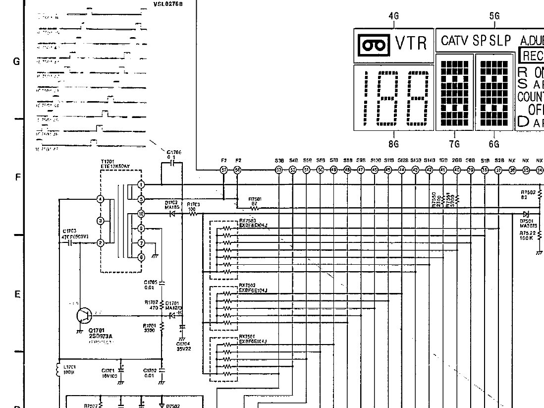

Wow! Thanks for the tips. I have the schematic here, and I can see what you mean about the +ive and -ive lines to power the display. The diagram (which I dont understand much of) shows something that might be the inverter you mentioned.

I've checked out the schematic, and it looks like the power comes from a little transformer labelled as an ETE13K60AY which is a panasonic part (it's a panasonic VCR).

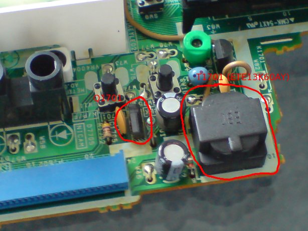

I've located the part on the board, and its a sealed unit, which from eye sight, looks ok. I did notice a little black transistor, and it has dark brown markings on the PCB, looking at the diagram, it's component Q1701 - Panasonic 2SD937A
It's a bit hard to power up, and get a multimeter onto it (without touching other things and blowing myself up), do you think it's a fair bet that the transistor could be broken, stopping the power to the VFD ?
I'll attach a snapshot of the diagram, which might mean more to people on here than it does to me.

Yes, the transistor has probably failed, although something might have killed it, this is essentially what's inside the TDK modules, obviously Panasonic have built their own on the board. There's a small choke feeding power to the inverter, if the transistor has gone short that will probably be O/C.

Most transistors can easily be replaced with other ones, the 2SD973 is 30V, 1A, 1W - the BC637 is 60V, 1A, 1W - so it 'should' be fine - but the gain may be lower?. The transformer is unlikely to be faulty, but the tuning and feedback capacitors may be faulty?.
I have some experience about vfd displays. Beacuse i was busy a lot with vfd display clock and vfd vcr displays. First tip: All futaba vfd displays from right 1. and end of the pins is vfd tungsten flamans voltage mostly ac volts around min 2.5 volt to 4.5 or 5 volts ( or sometimes dc 3.3 to 5.5 volts) when u look from front of vfd left 1. and all right last pin is tungsten flaman supplay pins. Depends some vfd have min 3 or 5 or 6 tungsten flamans. At the middle pins are greys. This pins are drives mostly cpu+ vfd driver ic`s. example UPD7537ACU or similar.To
this greys pins drives min.-25 or some of +25 to -35 or +35 volts drivers voltage. Most of vcr vfd displays you cant find data sheets you need service manual( you have already) But dont think all right or all left at the corner black point meaning is a problem. You have to look to last air desarjed point. If its not broken or cracked. Then you can be realex :)
Even if you can check manual all segments. You have to give tungsten voltages but not hight max 3.3 or 4.5 voltage first experiment. You musnt see all flamans giving light like a bulb :))) you mustnt see them when they give light only you can see in a dark room. or close with your hand make dark little bit you will see the flamans lights. Now next you need a crocidle cables. and -25 or 30 volt dc supplay voltage for manual check. But when you touch with crocadle cable yellow or red vfd light will came and later go. Like lcd because this displays also needs refresh signals. like at lcds. step by step you can check which pin goes to which segments. But also some vcr vfd mcu has also display test pins. Some of dont have or you can check of your vfd display mcu datasheets(if you can find). But possible this is a risk!!! Be careful. My manual vfd test is better. But desolder from pcf of your vfd display. Never experiment on pcb with mcu.

I picked up the transistor today, I couldnt get the BC637, so I got a BC639 instead, looks like the same spec's except the max voltage is a bit higher at 80V
I soldered it in, but alas, no power at the VFD. I discovered that my multimeter has a transistor tester built in, so I tested the old one I pulled out, and I got a reasonable reading out of it. So that shot down my theory about the transistor.
I'm not sure what to check next ?
I poked around with the multimeter while it was running, and found 14V coming into the board, after switching it off, I tested for continuity between the 14V connector and the transformer, and it showed a connection, I've tested the diodes, resistors and cap's that I could see around the transformer, but alas, still nothing appears at the pins feeding the VFD.

After analysing the circuit and taking some measurements I concluded that Q1701 had failed.
The Base Emitter voltage measure a steady state 16V dc whereas the rated voltage is only 5V.
As per the suggestions on this thread I replaced the Panasonic 2SD973A transistor with a BC639 and was delighted to see that the VFD came back to life. But alas only momentarily until the transistor blew and the VFD was blank once more.
I therefore concluded that something was causing the transistor to fail and replaced C1703 (470pF, 50V), C1705 (10nF, 50V), C1701 (100uF, 16V), C1704 (22uF, 35V), D1701 (27V Zener diode) and D1702 (small signal diode) but Q1701 still blew.
I then thought that maybe the BC639 may simply not be up to the task and replaced it with a BD649. This worked like a treat and still appears to be working fine.
So it looks like it was simply Q1701 all along but a BD649 is needed as a replacement, not a BC639.
