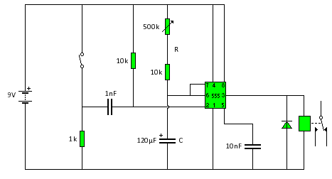

Where to get decent 120uF cap for 555
greg123
I'm struggling help please!
Looked on RS and Maplin and can find little 120uF which is needed for my 555 timer circuit other than low spec alloy, which I read isn't recomended for timer circuits as this circuit needs to be stable over time.
Can anyone suggest a suitable supplier for a good and stable 120uF cap for attached circuit?
Also, while on the subject I just got a basic 10mm trimmer for the Pot, it's vital that once the pot is set the circuit doesn't 'drift' much over time do I need any special kind of pot or is a normal trimmer, used once to set the time value going to be good at sitting there and not playing up/altering resistance?
Greg.
The problem is all large capacitors have a poor tollerence, you could add a 22:muF in parallel but I don't see the point.
You could use 100:mu:F, but that would only give you a delay of 56s.
Another option would be to use 100:mu:F add and another 100k trimmer in series with the 500k trimmer which would provide a more fine adjustment.
Use a tantalum capacitor rather than an electrolytic because they have a lower leakage current.

Get a 100uF and a 22uF 16v tantalum from Maplins and connect them in parallel.
Use a 20/22 turn Cermet potentiometer.
What accuracy in timing over time are you expecting from a 555 timer.
Does it have to be 555 based? A PIC 12F using internal timers/oscillator will consume less power and be way more accurate over time.
Also, could you use an opamp based capacitance multiplier and a much smaller (poly film) capacitor in the 555 circuit? Digikey has .1uF to 1uF stacked film caps for not too much, add a single opamp and 3 resistors IIRC and you can easily have the equivalent of 100uF or so.

Thanks guys. 56sec max timing is absolutely fine, in fact 45 sec max would be fine so 100uf sounds like it will do the job. I couldn't find a 100uf in 16v though, as I'm running up to 15v I figured the 10v ones are not good enough. I found one here that is 20% tolerance of the Tantalum type and 47uf, if I put a pair in parallel that should do the job right?:
No it doesn't have to be a 555, just want to keep it simple as this is a first project and won't develop, it's a simple "cut the 12v trigger supply, output goes high for x seconds once only" and that's all I want it for. ;-)

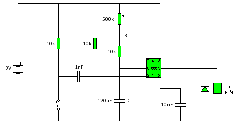

hi Greg,
Thats the type of trimmer I often use, it will be OK in your circuit.
As you are looking for longish term stability in the time period, use 1% metal film resistors in the timing section.
If its working in a car, you should consider the 'harsh' environment in a car, eg:
temperature range, humidity and vibration and electrical noise.
A low cost 9V battery will give a poor performance at very low temperatures, also use a CMOS version of the 555, it has a wider operating temperature than a standard TTL version.
Eric
PS: is Rediffusion still in Castle Boulvard.???
EDIT: if no one else posts a diagram, I'll draw and post it.

I wasn't trying to hijack multiple threads re the circuit but I have attached it here fyi, this thread was just because I was struggling to find supplier for the cap which now seems to be sorted if I use the ebay tantalum ones 2 in parallel (47uf).

I have seen 555 circuits with over 10 meg for R. I would increase R to 10Meg var. + one Meg fixed (for starters). This should require just about 5uf for the timing capacitor and overall you should have a much more stable circuit.
555 circuits or 7555 circuits?
Don't forget that as you increase the resistor value the leakage current becomes more important, past a certain point even the input current of the 555 needs to be taken into account.
Another way of increasing the delay is to add a resistor from pin 5 to +V. I can't remember the formula but it's on one of the application notes.
hi Greg,
The easiest way would be to get a low power 12Vdc relay [a high resistance coil] with change over contacts.
Connect the 12V relay across the car battery via a fuse.
Use the contacts on the 12V relay to connect the junction of the 10K and 1n0 to 0V when the relay becomes denergised.
This will trigger the monostable.
It could also be done using a couple of transistors or if you have on the shelf any CMOS gates, invertors you could use an ic.
What 9V battery life are you expecting.?
Remember also that on a cold day the car battery could drop to around 9V or so when operating the starter motor.
Does this help.?

Hi Eric,
Won't the above circuit be triggered by loss of 12v feed into the trigger side? I think the way Hero did it that it will breifly drop to 0v across the trigger and thus when I cut the 12v supply to the trigger side (12v will be kept to the power side, naturally) it will activate the output.
I'd rather not add in another relay if I have to as in another part of the circuit (outside of the timer) I already have two and it's got to go in a small box. Hence why I was after a circuit that would do a 'delay on break' without needing additional relays/transistors if poss, KISS and all that!
So no need for 9v battery, it will be hardwired in a car!
Greg.

Gregg,
The additional relay contact would only switch the trigger to the 7555 low, via the 10K/1n0/10K when the car battery is disconnected. The supply to the rest of the circuit will not be switched off.
Can you say whats the actual purpose of the application.?
eg: why do you want to detect the disconnection of the battery and whats the timer relay going to drive.? Maybe a block diagram.:)

hi MRCecil and welcome to the forum.
The 555, when configured in its monostable configuration as you have drawn, requires a trigger pulse to something less than 1/3 Vcc. The trigger input, pin 2, is one input of a comparator, and cannot left floating for proper operation to be viable; the high to low transition of the trigger pulse starts the timing. Simply removing the 12V will not get the job done. Pin 2 must be driven below the trigger threshold, ground is good, and back to Vcc for proper operation/timing.
This is the point I have been making, although the trigger is 'ac' coupled via the 1n0, the junction of the 1n0 and the input 10k must be momentarily connected to 0V.
Just disconnecting the junction, by taking off the car battery lead will not give an effective trigger pulse.
