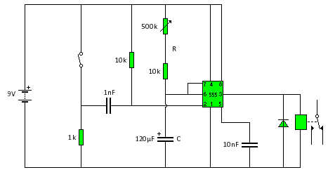

I can't believe how confusing I'm finding this simple circuit :confused:
Okay, yes, I did read the data sheet and understand the basics of 1/3 vs triggering etc but that's about it, I didn't understand any more there that would help me.
The application, the simple way I can think to explain is is a bit like courtesy light auto on when you turn the engine off. The circuit is powered by 12v live and normally it has a 12v feed to the trigger side. At this point the output is low. When the ignition is off the 12v feed to the trigger is cut, this needs to cause the output to go high which activates a relay and switches the interior lights on for a time between 1 and 60 seconds roughly, set by the trimmer.
I thought on the attached circuit that removing the 12v trigger feed would cause the 1k resistor to feed 0v temporarily via the cap to the trigger side till the 10k resistor has chance to pull it back up to 12v once the cap is charged? Am I wrong? If so, what do the 1k attached to 0v and 10k attached to 12v across the 1nf cap do?

Yes, the 1k pull down resistor will pull it down to 0V, when the 12V is removed from the capacitor.
I don't see why you're using a 9V battery, just feed the 7555 of a permanent 12V feed and disconnect the trigger.

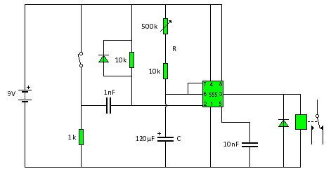

When triggering this circuit from voltages higher than the power supply be careful. This circuit already feeds double the power supply voltage into pin 2 for a short period of time but most ICs have protection diodes (especially the CMOS versions) so it isn't an issue.
If you have any problems, then add a diode across the 10k pull-up to clamp it at 0.6V above the supply to the 555.

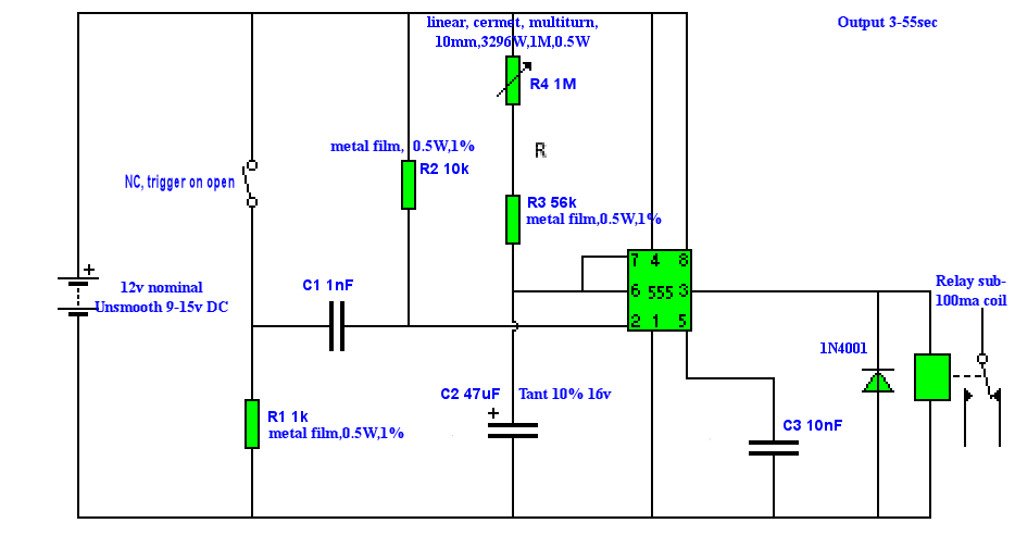

Please see attached, I have annotated which hopefully makes my supply and also componant choice clearer. I have dropped the cap and upped the R and hopefully everyone will agree this should be okay?
If this will do the job, the only thing I'm stuck on now is I can't find Tant caps for C1 & C3, the 1nf & 10nf. Should I use a different/inferior type of cap or can I use different values so I can use Tant?
I have put the type of componants on the diagram as well for comment if I picked anything stupid.

That looks fine.
I've built similar circuits using the TS555 and NE555 that uses an AC coupling capacitor with no diode and haven't had any problems.
I don't know about the 755 though, I assumed has protection diodes, it might not. The datasheet says the maximum voltage you can take the trigger above the supply is 0.3V so strictly speaking you should use a small Schottky diode like the BAT85 which will drop <240mV when the current is <0.1mA (which it will be 9V/10k = 900:mu:A).

I can pick another type of 555 if you think that would be better? I just picked this as it was there at RS and said it handled up to 18v and 200ma out, which seemed to be what I needed.
As the trigger voltage is connected to Vs, I don't understand how it can ever get higher than Vs? Again I'm not using a 9v battery, the trigger is a line from the 12v Vs supply through a switch so the trigger should have the same (or less, if switch contacts have a touch of resistance) voltage as the supply right? Unless I'm missing somethign ;-)
If I'm best advised to add in that diode maybe you would be kind enough to indicate it on the diagram, or if what I said above makes sense and I don't have to worry about it even better!

The application is like courtesy light auto on when you turn the engine off. The circuit is powered by 12v live and normally it has a 12v ign feed to the trigger side. At this point the output is low. When the ignition is off the 12v feed to the trigger is cut, this causes the output to go high which activates a relay and switches the interior lights on for a time between 1 and 60 seconds roughly, adjustably set by the trimmer.
The attached should show the feed/trigger lines as above and as I understand it produce an output in the range I require.

The components you've listed are fine.
If you're going to use the 7555 (which is probably a good idea due to the long time delay), then I'd strongly recommend using the BAT85 diode which can be bought from RS and isn't expensive.

2 q's, where do I connect the BAT diode? Also the 1nf and 10nf, I couldn't find them in Tantalum can I use different values? If not what sort of cap should I get for those two?

Just use ceramic capacitors for the 1nF, 10nF and 100n; I know it isn't on the schematic but you need a 100nF capacitor across the power supply.
I told you where to put the protection diode several posts ago, here's the schematic.
