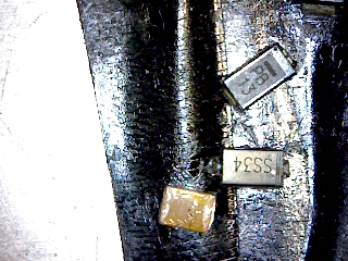

I toasted a SMD SS34 diode on aboard I have and went looking through my junk boards and came up with what I thought would work until sprouted legs and ran away, damn those thing are hard to find :banghead: I found another that appears to be doing the job, but I don't know what it's properties are, just that it appears to be physically large enough and appears the schottkey.
Is there a better place to look for specs than just typing "smd pb 13 diode" on google,worked for ss34 (40 v 3a) but not for pb13.
Will look more and finish reading copper tonite.

When it comes to SMD coding, since there has never been any standards. You can spend hours only to find something completely different.
There are many code books on line. Each manufacturer beats a different drum. Part of my job has been component replacement research for several years and when it comes to semiconductor SMD markings, it is usually a waste of time.
You are much better off try getting a diagram,reverse engineer, or even SWAG based on the surrounding components.
I have ran across the exact same device from the same manufacturer yet with different markings!
In my experience if/when you get familiar with a specific device manufacturer, they do tend to stay consistent as much as possible
If you get lucky, there may be a logo on the device (sometimes very tiny or even on the reverse side).
Sometimes you can try an image search with a clean picture.
Typing the device package type (SOTxxx) or even "body marking" with the code number may reveal something.

As with, SMD markings can and often do lead to incorrect part. PB as in PB 13 , may be a Varicap Diode, VHF Variable capacitance Diode, Close to NXP BB152. However the Connections on the BB152 differ on Datasheet from the PB13 image.
:Edited:
The BB152 may be That part, tho it is an obsolete component, replacement list if any attempt toward the PB 13 - possible BB152 as an replacement would be BB202, an updated number part.
Also again this is a drawing straws type of thing with SMD parts letter/numbering.
Used: The SMD CodeBook Marsport R P Blackwell, GM4PMK as a ref to that PB part. Again I refer to the term of drawing straws on the part itself.

Should have said this in the original post, the ss34 is the rectifier from a step up module, I let the output leads short together, OOOPs.
I'm still looking for 2 things, the PB13 specs, it came off of a server power supply board, right next to an inductor, so I figure it's part of a smps setup, but I haven't found the specs, it's forward voltage drop indicates schottkey.
The other thing I'm still looking for is the other replacement I found that grew wings and flew away, it had a forward voltage drop of .089v if I remember and read my meter correctly, even if that does seem low.
The PB13 is in the circuit and feeding a COB LED, voltage = 35, current = 600ma, seems like it's working.

I think you are chasing a red herring with your mark-code. I think it's either PB or 13. Since 13 gets you a transistor, it's probably PB, which gets you this: MA2Q736 (which I found in a full 2007 version of the Turuta book I got from somewhere). The 13 is more likely to be a date mark or batch number or something like that.
It's also worth looking for "SMD mark codes" "SMD top mark" and "SMD codebook" in your favourite search engine.
