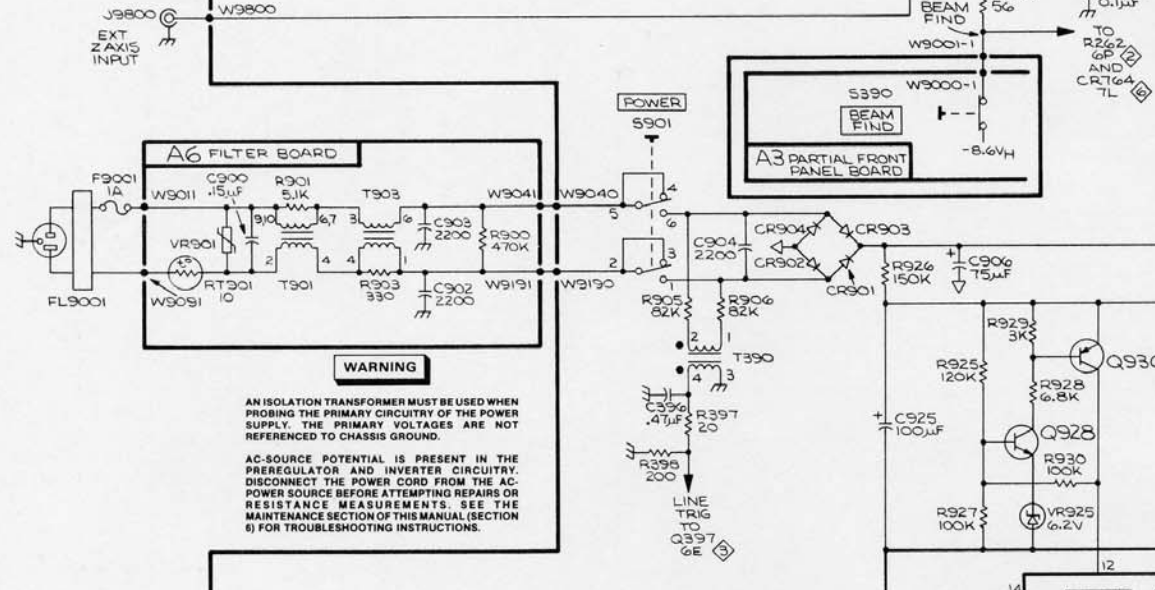

I would have loved to get a TDS 340 (JLNY I am jealous of your USD100 acquisition) but I settled for a USD100 2235A import from Singapore.

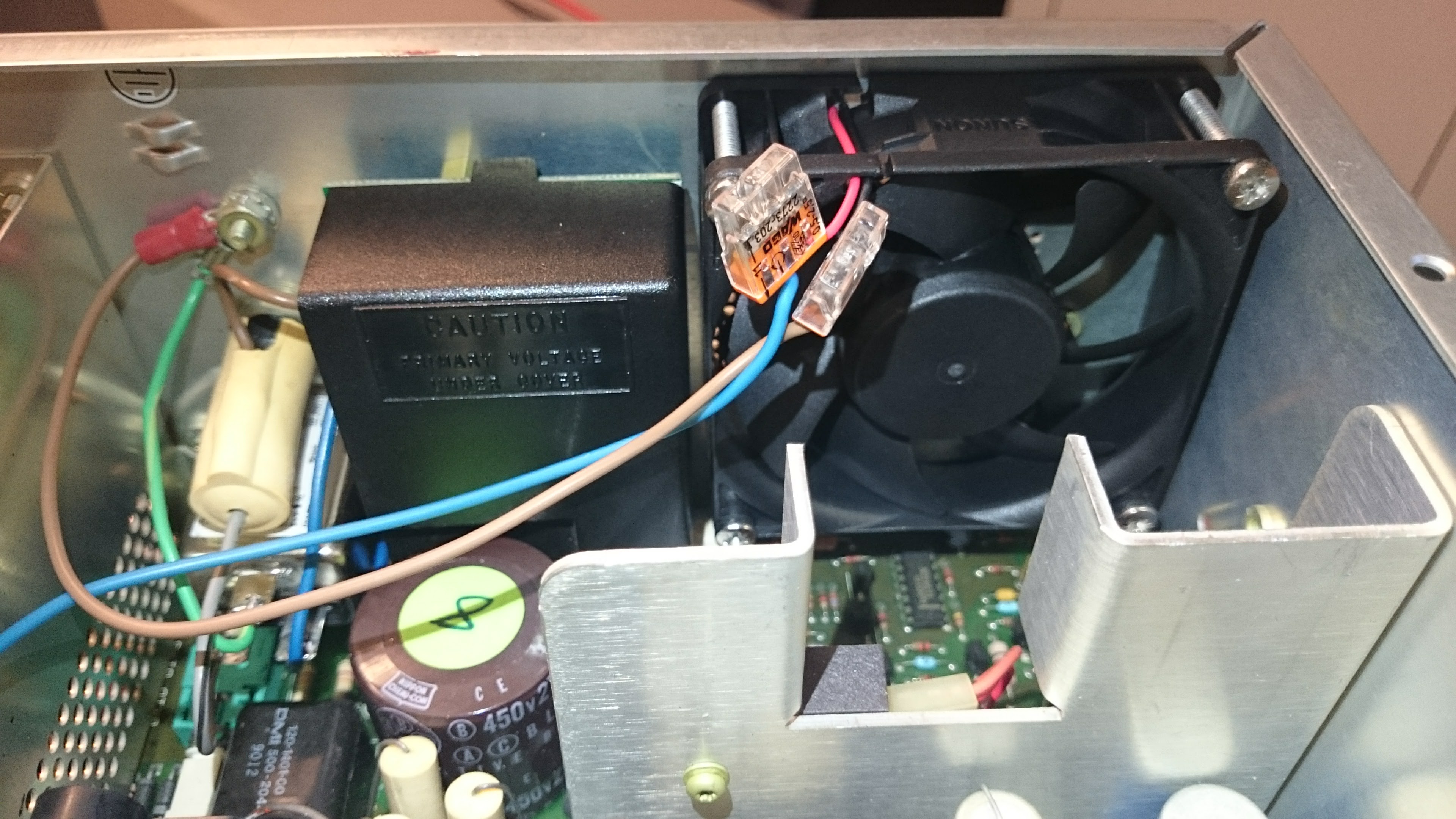

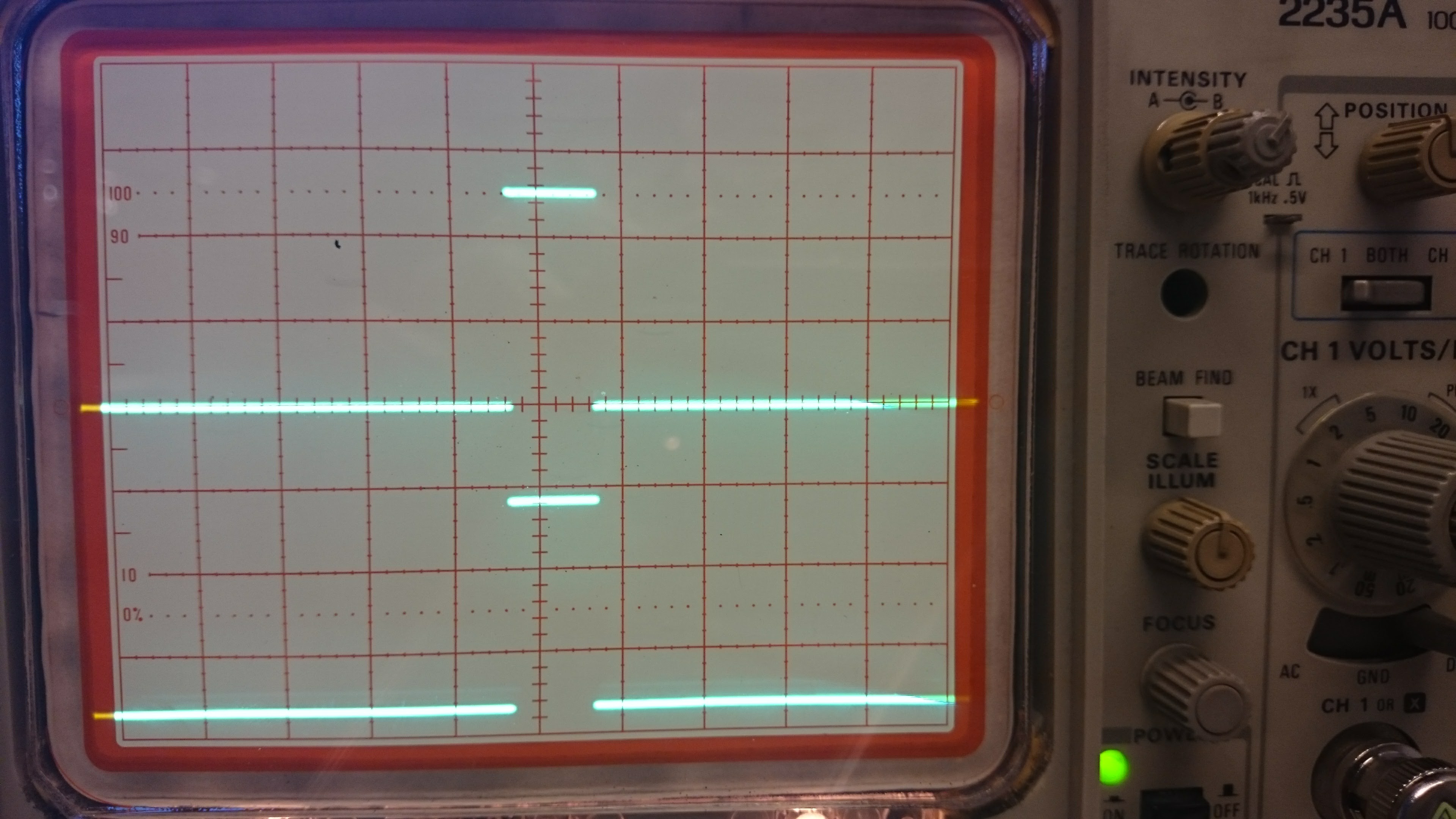

That unit blew up when powered up on arrival, but it was luckily only the filter capacitor on the main 220V line right before the rectifer, so I got that fixed. There is an issue with B-channel not reading properly on a few voltage settings (related to the rotary switch, probably wear) but I can live with that. I also added a ventilator in the PSU compartment.

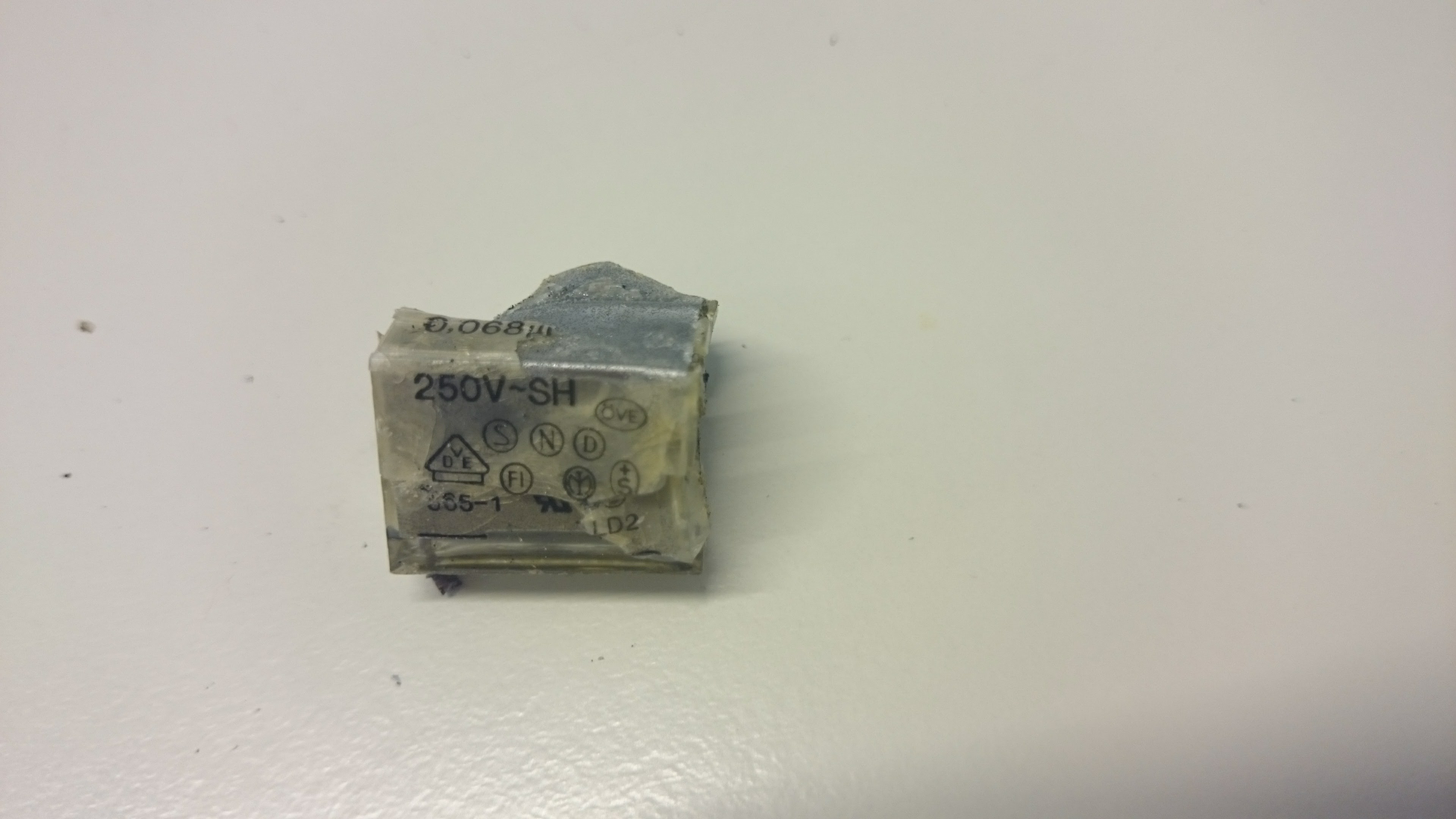

Hehe, my TDS 340 was indeed a lucky find. That said, the 2235A is very respectable scope, and I would say you did well to get it for that price. I'm glad to hear you were able to find a scope to use, and I expect you will get good use out of it. That's some rough luck on the bad capacitor, but it sounds like you did a nice job fixing it up.
Not sure what mains voltage you scope was used on for most of it's life. But on ex USA equipment that has been running on 120V you can get problems with the input circuitry if you suddenly run of 240V mains.
As a precaution I use a Variac and gradually increase the the mains input voltage to the equipment in 10V steps from 110V, to give the capacitors time to reform /breakdown and repair.

It was C904, I replaced it with an X2 rated 47nF 275V cap which is in fact too low (should be 240V*square(2)) but it is holding. I replaced the mains filter unit too and installed a ventilator powered off the 8.6V dc.
That capacitor is fine. Since X2 capacitors are designed for use across the AC line, their rating is in AC Volts.
