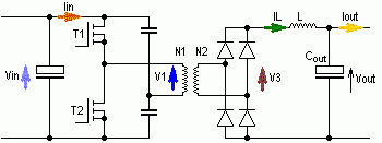

I am building an inverter from 12V to 310V 1kW. and I am really confused about topology .
I thing push-pull is good for low voltage inputs, but some people told me Half-bridge is better. But in half-bridge input voltage is divided by 2! and it will double input amps!
What should I do?

Since you want to build this yourself i'll still post some circuit topologies so you can think about all this for now.
Since you now have also revealed (since last time i read this thread) that your final project will have an AC output, i think i should add that in some of these topologies you can go right from DC to synthesized AC, where the synthesized AC is a much cleaner AC pulsed wave that is not as simple as the kind you buy on the web. That means the output AC filters to near perfect without too much trouble. The kind you buy on the web usually put out a single pulse with output amplitude equal to the average AC output, but using multiple pulse techniques allows going from DC to AC (with a transformer and full wave bridge as in E in the diagram but with no rectifiers) and the AC output is quite clean. The only thing that changes is the switching pattern of the four transistors.
Note that there are some other little things that come up like switching spikes across the transistors which requires snubbing networks, one for each transistor. You also have to keep an eye on the input capacitors ripple current ratings and things like that.
In the drawings in the attachment you'll see that some topologies require a more complex transformer and some less diodes. The one in A is not a good idea because of the high input current and the loss of 1/2 of the input voltage due to the capacitors. E is well suited for DC to synthesized AC (without the diodes of course).

What is the bold point on E? why not C?
Hello,
C is fine for DC to DC, i meant that E was better for going from DC directly to AC without having to convert to DC first.
You can go from DC to DC first, then later to AC, but this requires handling the power twice. It is done that way in some commercial products, but going from DC to synth AC means only having to handle the power once.
