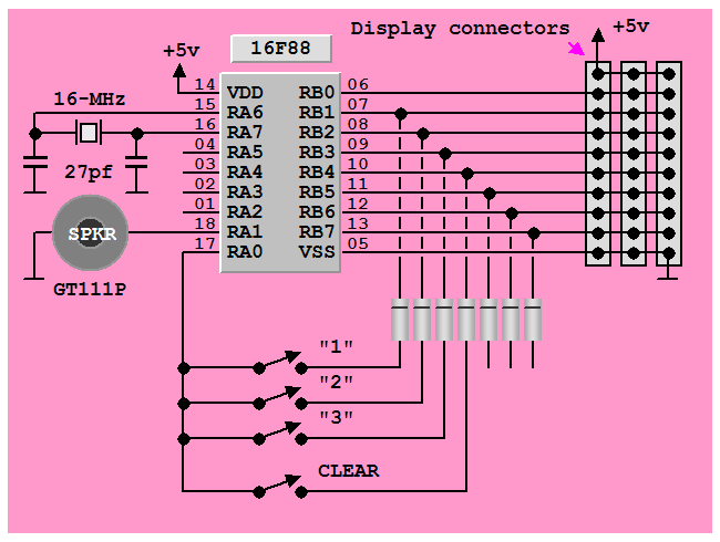

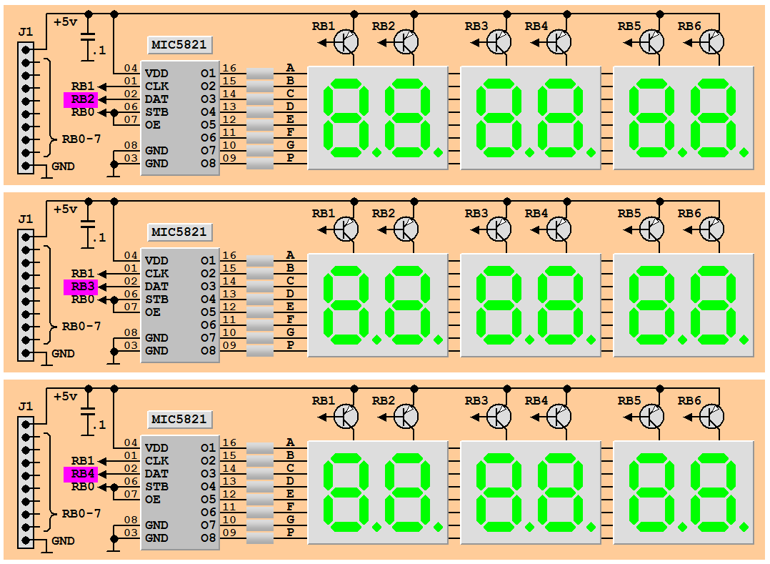

There's more than enough horse power in a single PIC to meet those meager goals (grin). You can easily drive up to forty two (42) 7-segment displays to full brightness with an 8 pin bus (Port B) while using only about 5% processor "overhead" in the display interrupt driver. Use the same 1-msec Timer 2 display driver interrupt to debounce switches (24-msecs debounce should be enough) and to increment the three counters (once every 10 milliseconds or every 10 interrupt cycles). Here's example code for one of the three counters;
; unsigned char Clock1 [] = { 23, 59, 59, 99 };
; if (Clock1_switch)              // if Clock1 running
; { if (Clock1[3]++ = 99)         // if hundreths overflow (post inc hundreths)
;   { Clock1[3] = 0;              // reset hundreths and increment time
;     unsigned char n = 2;        // index for seconds element
;     while (Clock1[n]++ == 59)   // while value 59 (post inc value)
;       Clock1[n--] = 0;          // set to 00 and bump array index
ISR_CLK1
        btfss   Switch1         ; switch 1 set (clock 1 enabled)?
        goto    ISR_CLK2        ; no, branch, else
        movf    Clock1+3        ; hundreths digit
        incf    Clock1+3,F      ; post increment hundreths
        xorlw   d'99'           ; done (no overflow)?
        bnz     ISR_CLK2        ; yes, branch, else
        movlw   Clock1+2        ; index for seconds element
        movwf   FSR             ; setup for indirect access
ISR_Bump1
        movf    INDF,W          ; while (Clock1[n]++ == 59)
        incf    INDF,F          ;
        xorlw   d'59'           ;
        bnz     ISR_CLK2        ;
        clrf    INDF            ;   Clock1[n] = 0;
        decf    FSR,F           ;   n--;
        goto    ISR_Bump1       ;

You might consider using that $20 USB-to-TTL serial adapter from FTDI. Just plug it into the PIC serial port and you're done...
My idea to the OP had taken into account the distance between the rings, the cost of running cables(both start/stop signals and LED display) from individual ring to a central location and the possible consequence of component failure. I consider a distributed self-contained system is best for the OP as I'm pretty sure money, large sum of it, change hands depend on the correct working of each of these displays. A system wise failure is not so good than a single ring failure. Also the price of a PIC(16F628a) is likely to be cheaper than a few meter of multicore cable.
