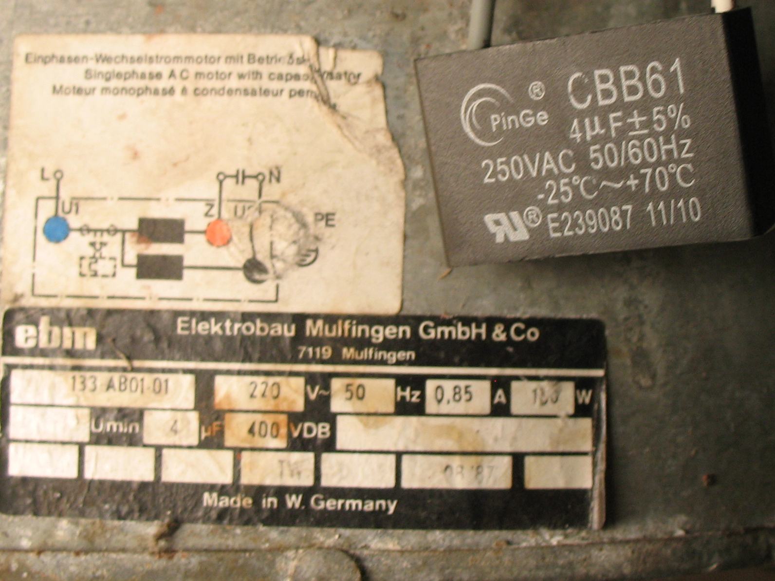

I have a fan from a paper drier, which has 4x wires Brown, Blue, Black and green.
Here is a photo of the connection sticker, with a capacitor I bought. Can anyone tell me which wires go where please?
I tried Brown, Blue and Green in a 3 pin plug, the motor hums and if spun starts up, but gets hot.

Measure the resistance between each of the 4 wires.
One pair should be the start winding the other the run.

Is the green wire a GND? i.e. go to the frame of the motor?
If so measure the resistance between the remaining conductors.
Max.
The nameplate data shows a 4.0 uF capacitor. I see what looks to be a blue dot, black dot and an orange dot? Would this be a reversable fan motor?
Ron
This is why I asked for the winding resistance, if both the same then it would be a common PSC motor and either winding would work, just opposite direction.

umm, that looks to be a 2 speed single phase fan description. L Load, N Neutral, Z... ? The capacitor looks to go to the neutral and the Z orange.
Also states minimum capacitor voltage would be 400V. Inductive system.

Green = GND/Body of motor.
Blue Brown 68 Ohm
Blue Black 58 Ohm
Black Brown 123 Ohm.
C.
Then I would consider that a PSC motor, if you Google the same, you will get all kinds of post showing the connections, with a PSC if you happen to hook up the opposite winding it will just run in reverse, if so just swap the windings over.

It's working!
Yes, it is reversible.
I can now understand the diagram at #1. The two black squares are the windings, and next to it the switch. The orange/red is Brown.
