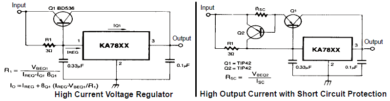

Assuming you're trying to get increased current from a 1A regulator, why don't you follow the suggested circuit from the datasheet?.

I have looked at the datasheet several times, I must be overlooking something. Please tell me what that is.

If you don't post the correct schematic, then we can't really help, the datasheets clearly show you how to boost the output using a PNP power transistor, but as you've never posted your schematic, we've no idea if you're following that.
