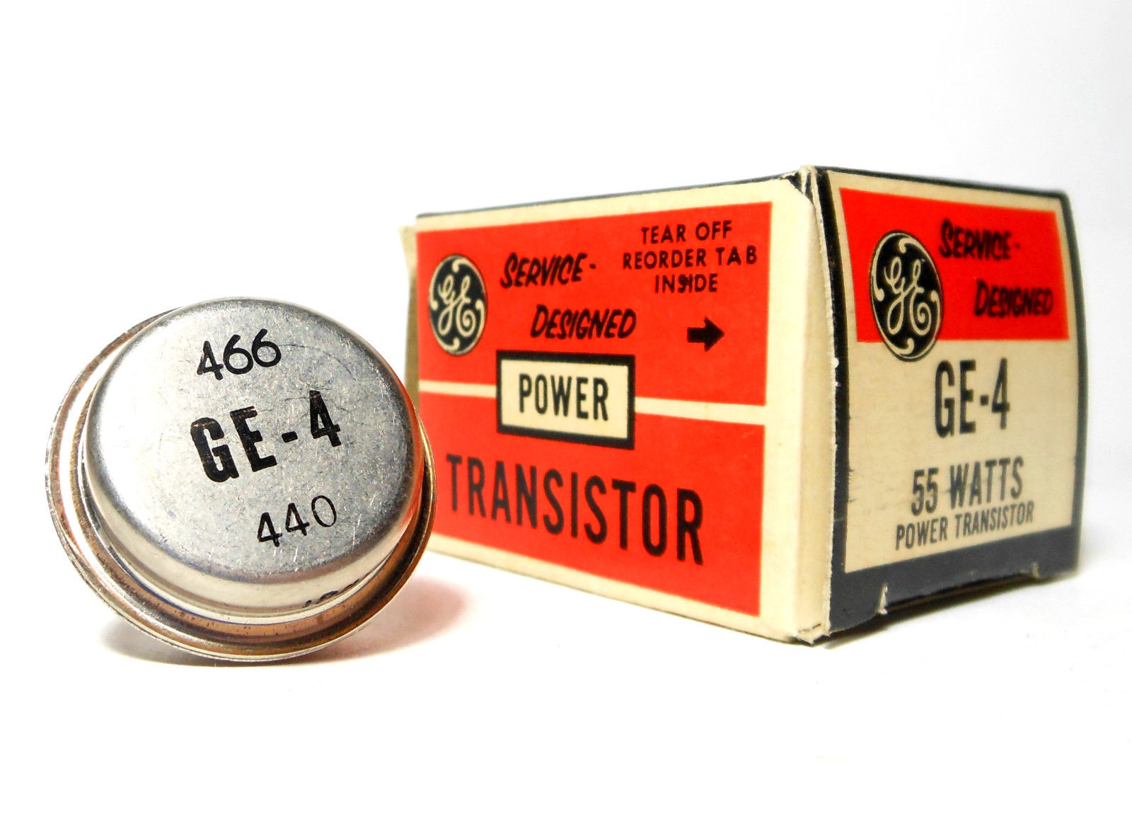

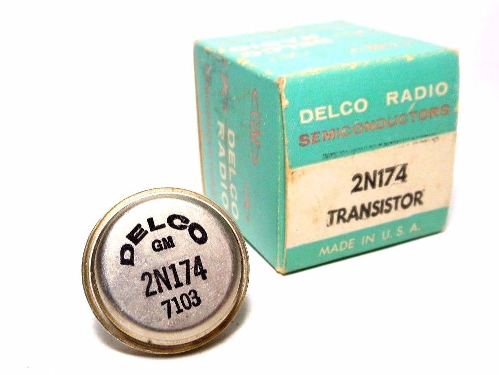

I did some searching too and found 12 replacements with 12 different numbers. Datasheet for 2N174 replacement says 55 watt audio amplifier amp emitter current 15a continious.
DS-501 = NTE105, 2N174, 2N2491, ID35785, 2N441, ID35785, ECG105, ELM105, 2N3315, 2N2081, HEP231, GE-4. I have only looked at datasheet for a few of these.
I have found Transistors for sale the box says the single transistor is a 55W audio amplifier. The transistor is rated 40v 15a.

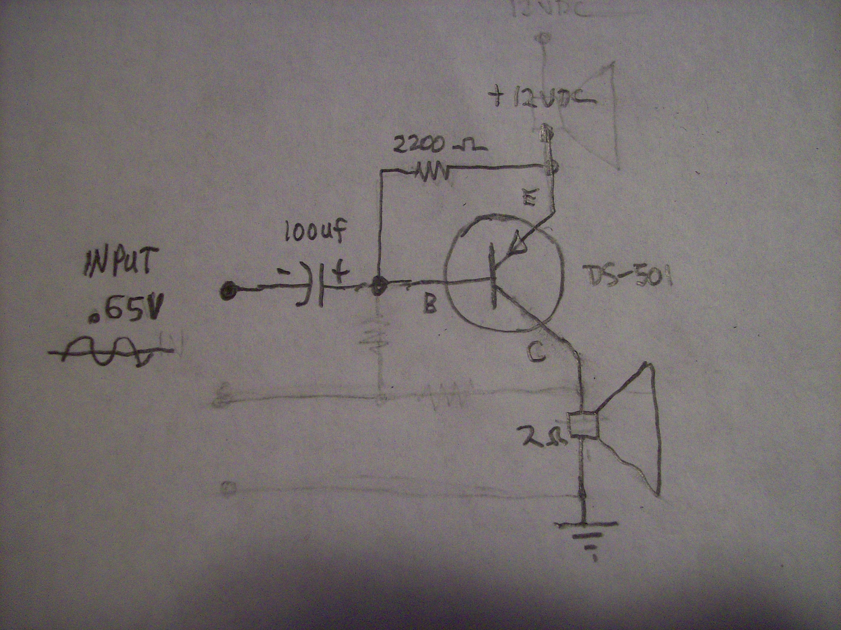

This thread is completely off track but it has gotten me interested in building an audio power amp using a 555 timer to make a 3 KHz HORN for my truck. This has to be louder than the tiny tweeter horn I have. I have a locomotive train horn for my truck with air compressor and tank it too large it needs a 11 gallon tank for 1 good loud 5 second honk. It takes the air compressor 5 minutes to honk again. The train horn is rated 150 dB I'm not sure audio amp horn can do that.
High power in a speaker is produced by having lots of current.
Lots of current is produced by having a high voltage and/or a low impedance speaker (2 ohms).
60 years ago an audio output transformer boosted the output voltage but today a high power amplifier uses a DC to DC boost converter.

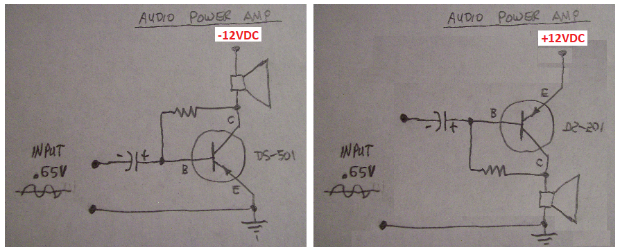

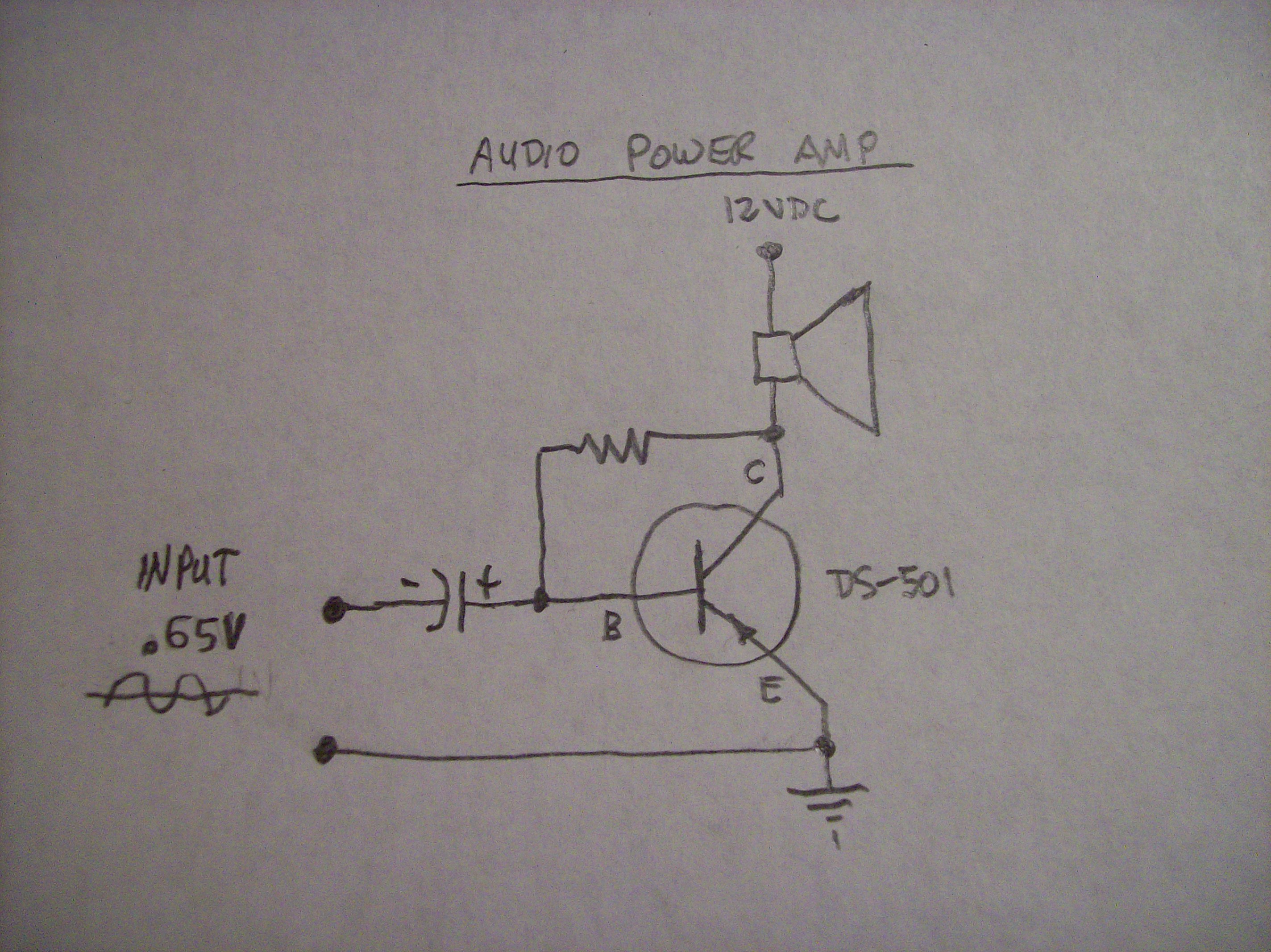

This could be a fun project if it works. I found this online circuit I have no clue if it really works.
Your DS-501 transistor is PNP that needs a -12V supply. It won't work because your truck has a +12V supply.
The speaker has DC in it that moves its coil to one side instead of back and forth then it works very poorly.
The power is low because 12V/8 ohms makes a current of 1.5A for only half the waveform. Then the power= 12V x 0.5 x 1.5A x 0.5= 4.5W.

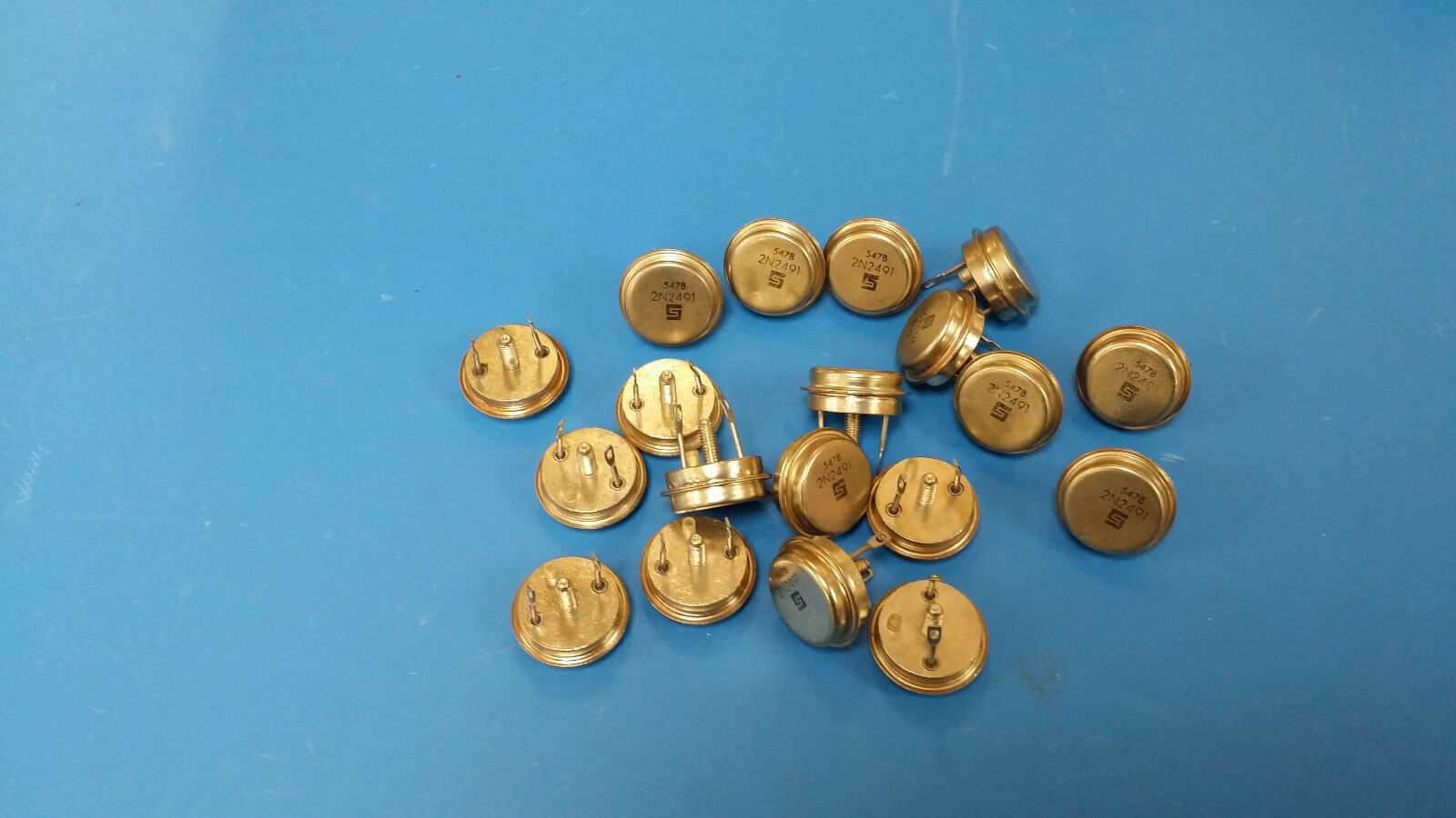

WHY do these 4 transistors work good in parallel?
Maybe they don't. Just because some one found 4 transistors in the junk pile does not indicate they worked good. I have a huge pile of prototypes that .....
I think the STA7018 is the same as the 2SC1413A (according to this page: https://www.ceitron.com/semi/ceisanken.html )
It has quite a high VCEsat 10v@5A so maybe that's why the paralleling works.

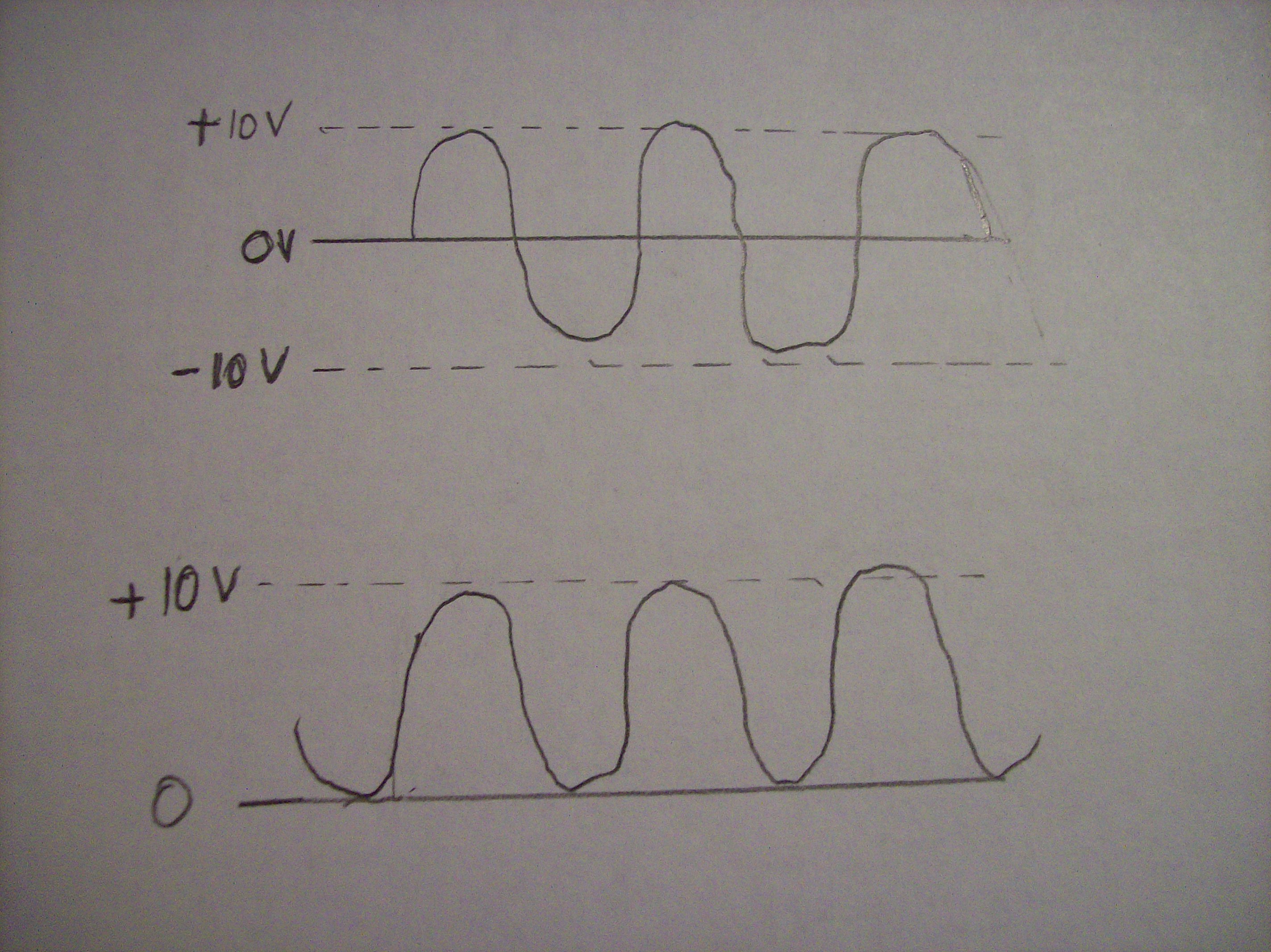

What is a real class A amplifier. +10v and -10v or +10v to 0 volts to 8 ohm speaker.
I think it is plus and minus 10v?
I think +10v to 0 might be class C but I remember is college we were told class C sine wave is cut off at 70%.
A class-A amplifier usually uses a single output transistor that is conducting and heating all the time. Your previous post shows a DS-501 transistor in class-A but instead of using a DC load resistor then a capacitor coupling the AC to the speaker you wrongly use the speaker as the AC and DC load.
A class-C transistor conducts only part of the total time which is never used for audio but is used for RF with a tuned LC to produce the entire voltage swing.
You showed a sinewave with AC having plus and minus 10V peaks but no DC bias, then you show another sinewave with a +5V DC bias and a swing from 0V to +10V.
