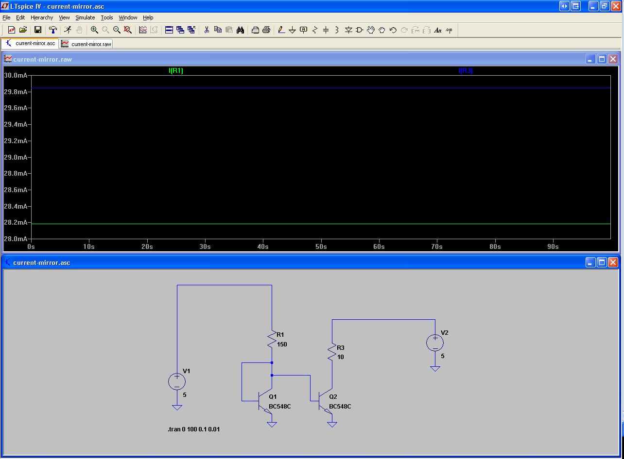

I want to make a current mirror. I did do some simulations and that works, but when I make a real current mirror this does not work. I made the current mirror also with R1=150R so I=28mA, but then the current in R3 is as follow with different resistor values:
R3=100R I=34mA
R3=56R I=41mA
R3=47R I=44mA
R3=33R I=48mA
R3=22R I=52mA
R3=10R I=57mA
R3=5R I=61mA
What am I doing wrong?
I did use a BC548B and simulate with a BC548C, but that should not matter. I also tried other transistors and the current in R3 is never near the current in R1

I understand the theory as explained on the link. My simulation is working as expected. Why should I post my simulation file?
My real circuit does not work.

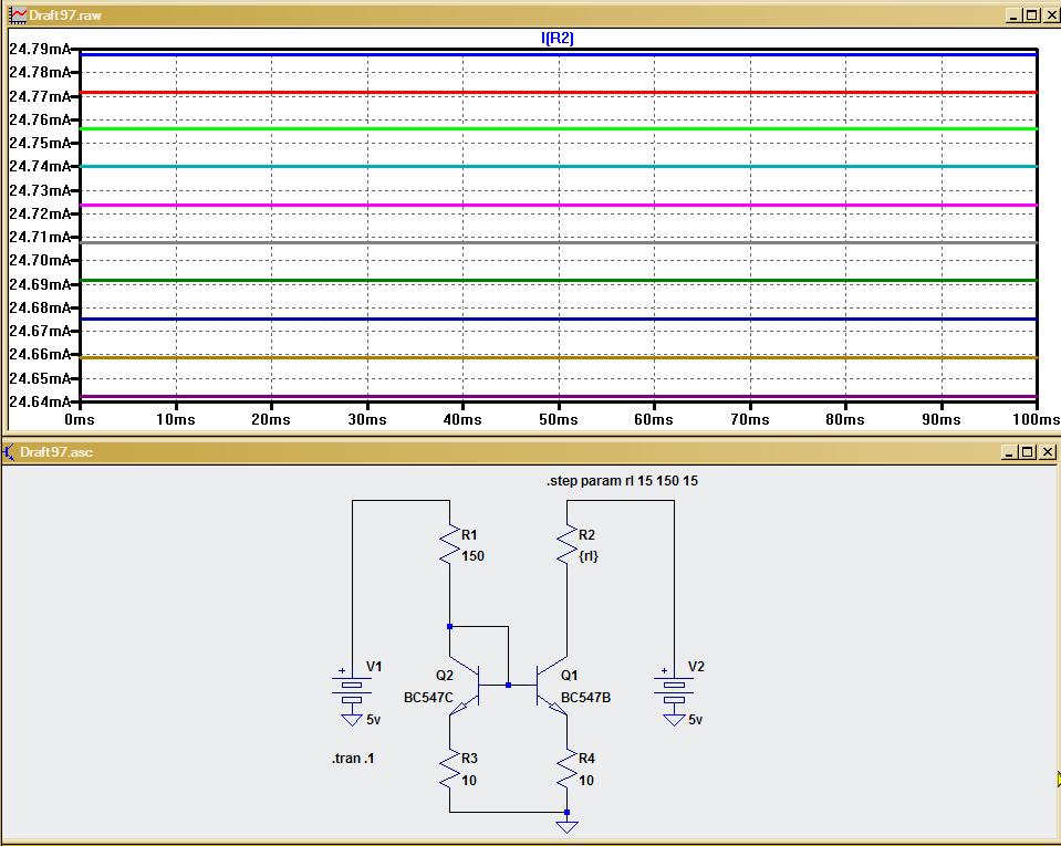

If you understand the theory, have you considered that the transistor gain in the real world should be matched in order for the tracking of the two collector currents to match,??
I asked for your asc file so that I could change one the transistor types to another BC with a slightly different gain.... you try it and you find it will not track..
I know the gain should match for equal current. But if the gains are a little different, the current through R3 should remain the same while changing the value of R3, Right?
Attached the ASC file.
I also build the circuit with a PBSS4021SN, which has 2 transistors in one package. This configuration does also not work. The current through R3 is increasing when decreasing R3
I hope you can help

Add a 10R thru 22R into each emitter connection.
Without balancing resistors, its the 'slope' of the mismatched transistor gains that can cause tracking errors.
Thats why your original table of results shows an increasing error.
This shows the effect of the emitter resistors when using different gain transistors.
OK, I add a 10R resistor to each emitterand now it works much better. Now the current through R1 is 26mA and through R3 is 30mA for any resistor value (lower than 150R). It's not as in the simulation, but this is OK
