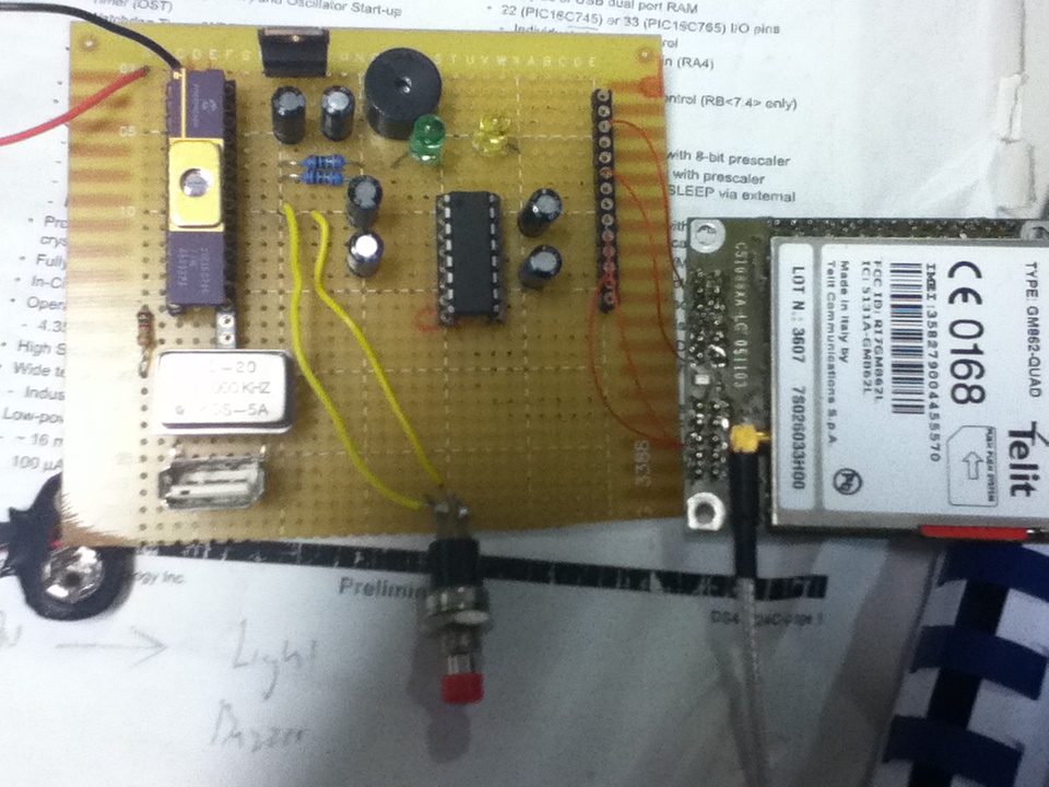

Hi there,
Im doing my final year project that asks me to store the information (entered in the GUI) in the PIC16C745 on my board. But i cannot set up the connection between them. I just use the USB Connector to connect the USB Port on my board and PC, i also installed the HIDComm in the Visual Basic and checked all the connections(they're all corect).
Can someone give me some suggestion???VERY URGENT!!!
The picture of my board is in my attachment.
Thx alot..

does it need drivers? when you plug it into pc does it even recognise something has been plugged in? are you sure your usb works? does it need external power if so is it on? thats all i can think of that might help

i use the external Power Supply and when i plugged in, nothing happens, but when i remove the external power supply, the PC can provide the power support for my board(why??)
The caps are mandatory. Too bad you're stuck with that 1990's JW PIC. Check out my Unicorn kit manual to see where the caps tend to go.
Looking at the Telit hardware manual.
How are you powering it with 3.8V?
How are you turning it on (needs a 1s low pulse on the /ON pin)
It needs 380mA, that's more than a traditional USB will supply by default, your USB firmware will have to request more before powering up the Telit modem.
Seems the device does not need the MAX232 as it's logic level serial.
Those hardware handshaking lines might be useful.
Edit, since the PIC is 5V you will need some form of level translation as described in detail in the Telit hardware documentation.

I just got 150nF capacitor can?? I think it is connected between Pin14(Vusb in my PIC) to the 5V..
The GSM Modem can work(to send message), my problem is only about the USB transmission.=]
Thx!!
You still need at least one at VDD & VSS, another 150nF cap is fine. You oscillator might do well with one too.
How do you know the PIC is communicating with the Telit? Do you have a serial port analyzer connected?
How are you powering the Telit? Where's the 3.8V supply?
Isn't the VUSB cap supposed to go to GND & VUSB?
Is this your first PIC project? USB is quite difficult even for seasoned PIC programmers, doing it on a UV PIC would be sheer hell. Worse yet on an ancient 14bit core PIC to boot.

The project is to send message to cell phone when i press the push button on my board. This part is successful that i provide a 9V to the Modem.
I try the capacitor first~=]
I tried to connect like, Vusb-->capacitpr-->GND, but it still didnt work..=[ =[ =[
The 4-pin USB should be connected like GND -->D+ -->D- -->5V right??
Hi gomera the bypass cap ( your 150nf) should a close as you can between the Vss, Vdd pins. The osc doesn't need any external caps as that type of can osc the caps are in the device. As Bill has said for a student using such an ancient UV erase pic will be a hard job. But I do take my hat to you for trying to do your best. Could you upload your code as there might be a problem there and we can help if there is.

You mean that i should put my cap between Vdd(Pin20) & Vss(Pin19)??Should it be between Vusb & GND..already blur...
I use Visual Basic to create my GUI and use MPLAB to wrtie C++ in my PIC.
In the MPLAB, I create one Source File & two Header Files, which i also not sure about..

Maybe i can just connect one PC to another PC, and load my GUI in both PCs to test if it can detect the signal??
Good idea.
I would suggest taking the Telit module out and connecting your project to a PC serial port and see what's happening. Without a simulator, debugger or ICE you've got quite a battle ahead.
Are you sure your PIC code works?
