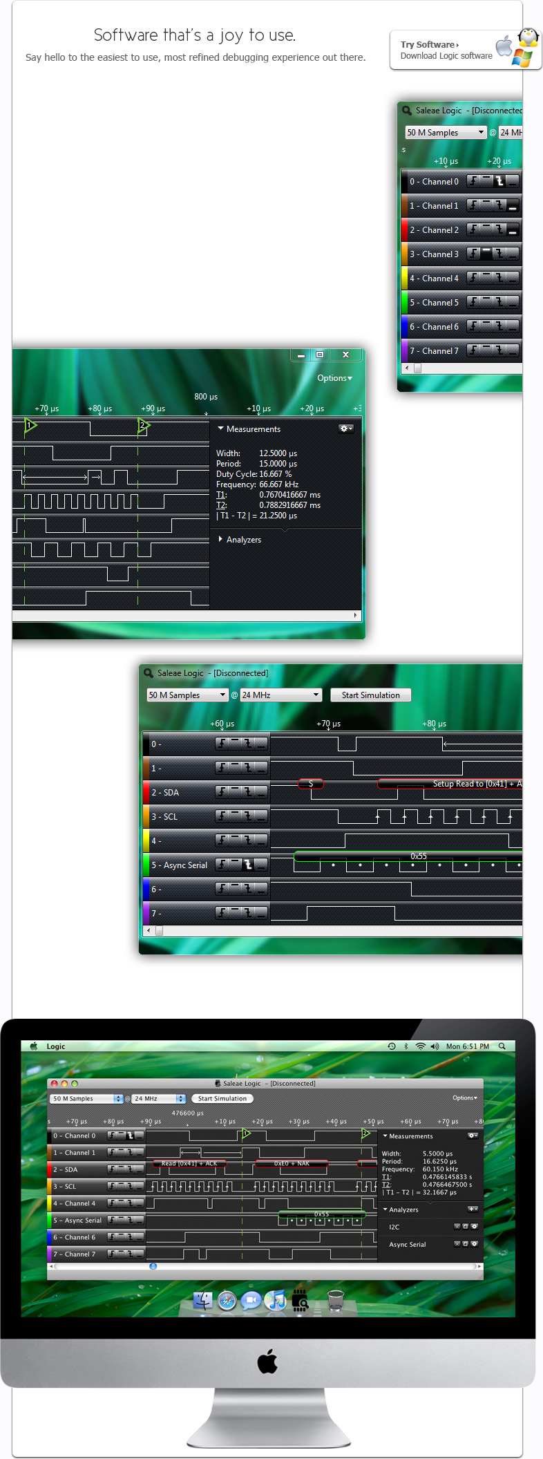

The worst problem is with rapid development systems like C# JAVA etc. But they have their place. A case in point is the logic analyzer.
The created the product using C# and .NET. His customers wanted it on the Mac and linux so he started over using more conventional coding with the aid of a cross platform toolkit. It took 2 years! The story here is that in spite of the code bloat and speed requirements there is a place for a language that will let you rapidly develop a product and get it to market. In this case money from the C# version funded the development of the cross platform code. The C# is a more polished GUI. One could argue he may have been better off staying with the C# code and spending the 2 years on additional post processors or new products. My bias here tells me the Linux people are too cheap to buy one and how many embedded types use Macs anyway.
C is is more of a mid level language. But the guys who code uC's in C do not need gigabyte processors and gigabytes of memory. The C code is about the same size and runs at about the same speed. All but the tiny apps pointed out by RB.
