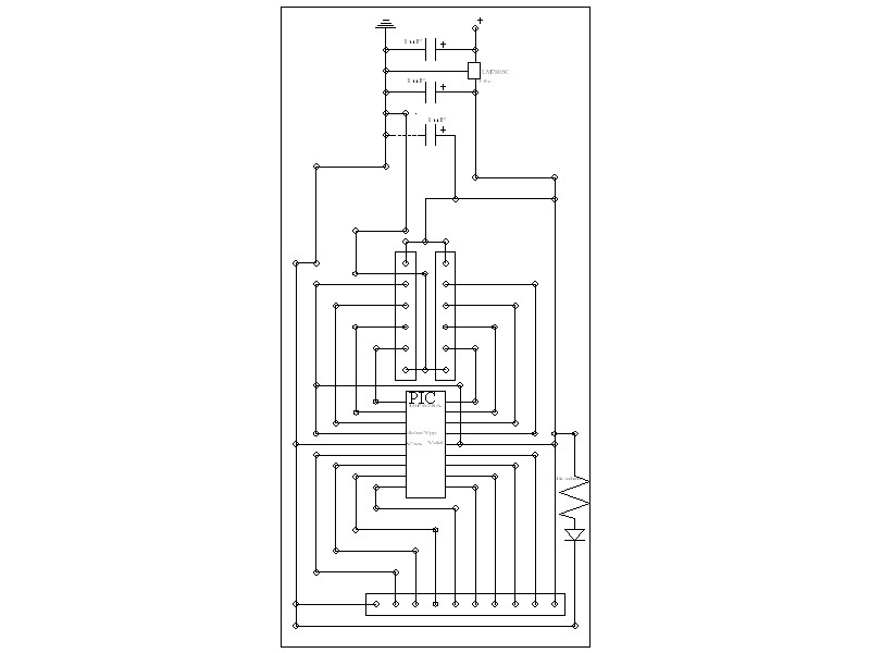

If I am correct and you have CONFIG pin#5 as MCLRE, ie:ON, it means the PIC is not being RESET at power up.
If its set to OFF, so that you can use it as an I/O pin, then the PIC's internal Reset line is connected to Vdd, so its reset OK.
That means you can use RA5 as a I/O pin.
Look at the CONFIG Word on the PIC's datasheet.
Are you using a +5Vregulator between the battery and the PIC??
Does this make it clear?

Yes I am using a 5V regulator between the PIC and battery (LM7805C) and in my source, should I set MCLRE_ON to MCLRE_OFF? I always thought that pin 5 (ie VSS) was supposed to be connected to the ground terminal?
I think that pin number 4 is MCLRE; because thats how its connected on my programmers schematic, and all the LED's work off the programmer. So after a quick glance I'm assuming that I also need to connect pin number 4 to +5V but can anyone confirm this just in case? (By the way; how did you find out that pin 5 is MCLRE?)

Do you have the datasheet for your PIC?. if not download it from www.microchip.com
If look at the pin designations on the datasheet, you will see some pins are multi-function and have to be configured
to perform the function of your choice.
A quick look at pin#4, shows it as either RA5, MCLR [or Vpp], the configuration word CONFIG at the near the top of your program code sets the function of RA5.
Bit #5 of the Config word reg, if set high makes pin#4 the MCLR, if low it a inp/out pin RA5.
IIRC in your code Config bit#5 is ON [hi] which makes the RA5 pin MCLR.
Looking at your diagram, pin #4 goes to a connector and dosn't show any pullup to +Vdd. [unless its somewhere else off board??]
Your code runs OK in my sim, which it would do, even if MCLR was not connected, thats one of the shortcomings of simulators.

Ok, I have the data sheet and I see pin 4 as MCLRE or Vpp. So do I need to connect that Pin to a +5V (where my Vdd is connected to) to make my program work? (The schematic of the programmer and the way I've seen it run makes me assume it does) And I think I'll try it out tomorrow once I pickup a new 9v battery.
How do you see bit#5? Is it the hexidecimal H"005" or the 5th one down on the list? Could you please copy/paste what you were talking about, in the program, and explain it?
Do you have a picture of the schematic you are referring too?
This is your Config statement.
So would this new schematic fix my problem or should I add in a resistor somewhere between pin 4 and +5v?
There is no point is 'wasting' a pin, when you can use the Vdd internal MCLR by changing your config word.
Just change the config word as shown.
I don't really mind wasting a pin (although it's kinda too late now)... I've already kinda soldered my pic onto my board being sure it will work. >_> Anyway, do you htink my new schematic will make my program work?

Where else does pin#4 goto?
What are those two rectangles on your drawing?? 'red circle'
What will they be connected too?
The two red connectors I could potentially use on sensors or another board and for the particular use of this Microprocessor I don't really need Pin 4 anyway, so I guess it doesn't connect to anything else.

I would recommend that you modify the Config as I have shown and keep pin#4 connected as a port pin RA5.
