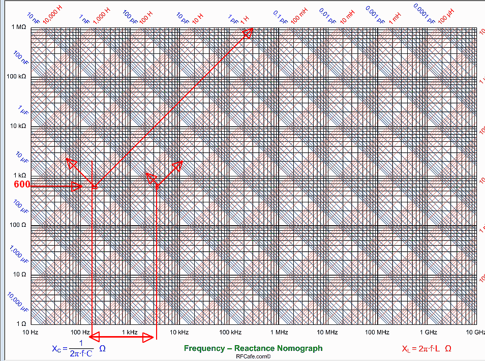

Transformers are not rated by impedance rather by inductance L and resistance R with a T=L/R the pulse 63% decay time . The half power Bandwidth (BW) is when the resistive load matches the inductive impedance X(f)=2 pi * f * L
Also the wire resistance must be a low % of the load impedance. 1% to 10% as resistance does not transform any power. It just absorbs it.
Because of inductances and interwinding capacitance, it is not cheap to make one with more than 2 decades of bandwidth and high X(f)/R ratio unless something is compromised.
Audio Transformers are sold by audio circuit impedances when the frequency range is defined, but the design must be done in inductance and inductive impedance.
