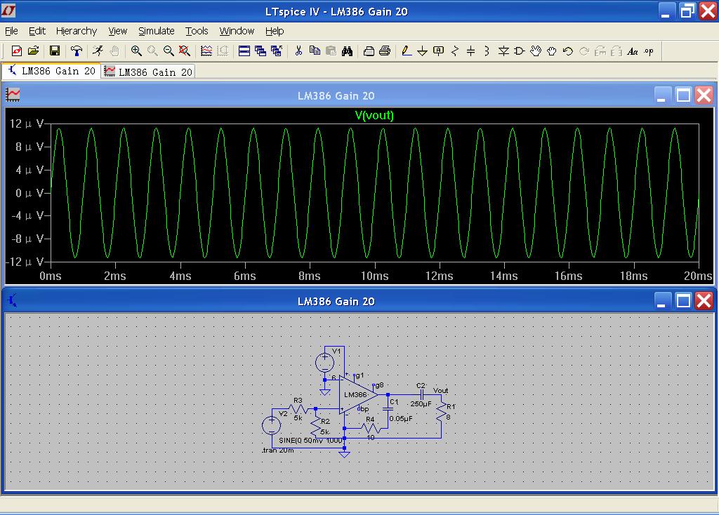

There is one simple circuit for LM386,but when I simulate it,I can't get the right result.Per LM386 specification,that circuit power gain is 20.And the input sinewave sinewae is 50mv,so the output pin5 will get 50mv*20=1000mv=1v(Pls note:LM386 power supply voltage is 6V).However,the simulation result is 12uv, not 1v,I don't know why happen this,pls correct me if I'm wrong.Thanks.

hi wealth,
The amplifier circuit is incorrectly wired.:)
Please post you *.asc file.

No.
It is wired correctly but has a "divide by 2" voltage divider at its input so its output for frequencies from 100Hz to 100kHz is 0.5V.
Why bother simulating it? The LM386 is simply a piece of wire with gain.
The sim program doesn't know anything about it.

Woops!
Misread the type number as a conventional OPA, not an audio amp..
