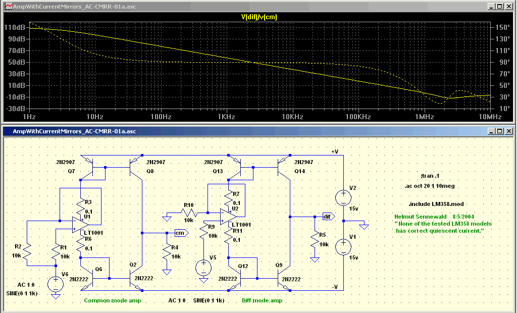

I had a play with your sim, but with the LM358 replaced by LT1001.
Here's what the CMRR plot looks like
  • AmpWithCurrentMirrors_AC-CMRR-01a.asc

It's not my circuit. In this post I attached the whole circuit. you changed it a little bit I don't know why did you connect one of 10k resistors at inverting op amp terminal to SINE voltage source and the other 10k in second op amp was connected to the ground?
So that one amp operates in common mode and the other operates in differential mode. Then we can plot the CMRR (diff mode gain / common mode gain; equivalent to V(dif)/V(cm) since both amps have the same sine input)
