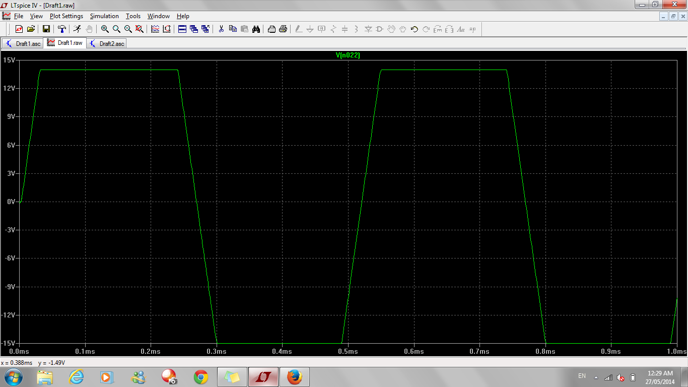

I can do one of the things out of 3 things that you mentioned before for increasing gain. Actually for increasing gain I can only increase 1k resistors at the output of current mirrors. when I do change 1k at the output of current mirrors and decrease 10k to 1k at the output stage, I get this error : "Singular matrix: check node u4:24 iteration No.2"
I don't know how can I solve this error?

This circuit is one of the most interesting circuits that I've ever seen. by changing 1k to 20k at the output of current mirror I get another error! :-( In theory
changing resistors at the output of first stage buffer, output of current mirrors and 10k resistors at the input of last stage should give me a high gain, while they make the result worse.
Singular matrixes and problems with convergence come up for a number of reasons and most of the time it's not the circuit it's the simulators fault. Sometimes just changing the minimum step size can help solve that issue. It could also be those 1 ohm resistors, as you know i added them just for a simple test earlier but they are not really needed anymore.

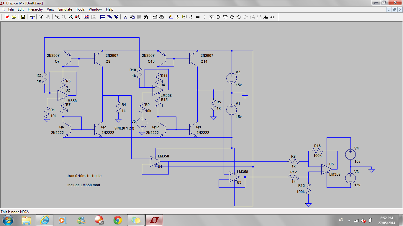

If you post the .asc file for the entire circuit i'll take a good look. I drew up part of the schematic but not all of it but since you already did i might as well use the same one you are using.
I did simulate this circuit without 1ohm resistors, those kind of errors happened again. By the way I attached .asc file for you to check and test it better.
Ok give me a little while to take a look. I'll get back here in a little while from now.

Ok your file made it much much easier to see what is going on. This way i get to see first hand what progress you have made.
The first error i got was that "R" was not declared anywhere. This error was found in four places, and turns out it was what used to be the 1 ohm resistors but the value had been changed to simply "R" and not some value like 1 ohm, 2 ohms, etc. So the first thing i did after that was change all of them to zero ohms, "0".
Next, i got an error that said that R11 can not be zero ohms. That was one of the resistors that used to be 1 ohm, so i changed all four to 0.1 ohms.

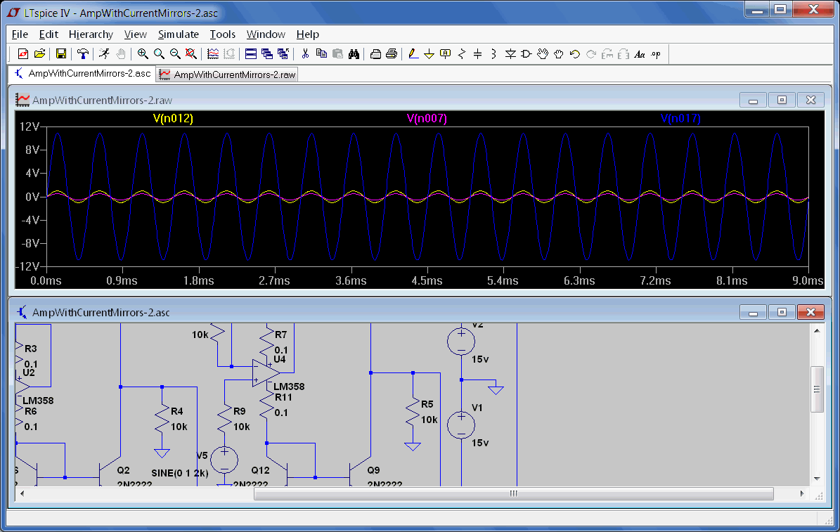

After that the simulation ran normally, and i clicked on three different nodes in order to observe the voltages there.
In the attachment we see the simulation run. The nodes are:
Yellow: input voltage (1v peak)
Violet: output voltage of one of the current mirrors (i think it was R5).
Blue: output voltage of the final stage.
Comparing the input voltage (yellow) to the output voltage (blue) i find that the gain is 10, as expected with the new 10k resistors on the outputs of all the current mirrors.
So try it again with the new resistor values of 0.1 and see what happens. Remember there are four of them to change.

Ok, when you increase the gain past a certain point the output of the op amps (one or more of them) may saturate, which could cause problems. This means when you change the two 10k resistors on the output of the two input buffers to 1k then you should use an input test voltage of 0.1v instead of 1.0v. That means we should still get 10v peak on the output even with resistors 10k and 100k for the output stage resistor pairs.
BTW i did verify that a lone LM358 with the two current mirrors does in fact get it's apparent slew rate increased as per our previous discussion, where the voltage gain is increased because of the current mirrors and choice of output resistor and current mirror output resistor.
This means that i was able to pass a 50kHz signal through the amplifier with a voltage gain of 10. This would be unheard of for just an LM358 with no additional parts (other than gain resistors) as that would only go up to about 8kHz with 10v peak output, and anything higher in frequency would cause severe distortion.
So we see one benefit from using the current mirrors, the slew rate has increased 10 fold. I did not try any higher but i have a feeling we could go up more yet and still get acceptable operation.
Of course there is still the DC input offset but that's another issue which may or may not affect the end application.
Using values of 1k and 9k to get a non inverting gain of 10 with a lone LM358 (no additional parts) and a 10v peak output, the max frequency is close to 8kHz before distortion sets in. With the current mirrors and the LM358 used as a voltage follower, the max frequency goes up to about 80kHz, which is a 10 fold increase in usable frequency and that's pretty significant.
This is still in theory, so there may be practical issues such as current mirror transistor matching and stuff like that, but it looks very promising.
I could show a simulation picture but it just looks like two sine waves, one is the real output of 10v peak at 50kHz and the other is the 1v peak input voltage synthetically amplified to 10v peak just for direct comparison of the input vs the output waveforms. They look identical except for the small output DC offset caused by what i think is the input offset of the LM358 itself.
