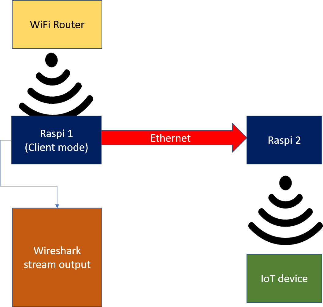

Wifi /Zigbee based temperature sensor to be connected to web-based application
Yep, exactly.
I'm not sure of the details of that device - it says "powerline" so it may only function if fed via another powerline adapter; it only mentions client mode / ethernet output..
Something like this looks reasonable - it says explicitly it works as an AP if connected via ethernet:
Linux - because far more networking tools are available and it provides better access to data streams between network connections; windows is pretty much crippled for things like that.
Much appreciated. I've updated my bill of materials and will be updating soon when I've gone through it.
