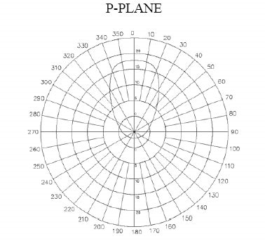

Higher gain antenna will not hurt the adapter. Remember however, that a yagi is directional, the signal is strongest in the direction of the yagi, at the expense of other directions. That is, it may have 16dBi gain in the direction it is pointed at, but may be -10dBi or worse in other directions.
A higher gain antenna magnifies a signal that is too weak otherwise for proper operation bringing up to a reliable level. Like a lens is to light, should not harm circuits.
Exposing such higher gain/magnifying antenna to excessive Rx levels can saturate a receiver even if properly designed, but falls beyond the safe needs.
For Tx; does not abuse the transmitter capabilities nor its power demand.
16 dB Yagi may not be useful if you cannot aim directly to site and don't move, something like binoculars. Maybe you should explain the reason you want it or symptoms of problems now.

Thanks. Higher gain yagi antenna is the most beneficial antenna for my situation because I know the location of the AP. I just want to ensure that higher gain antenna cause any kind of damage to my computer so I do not risk my computer.
There is no risk to your computer but 16 dB gain on the Tx signal is not friendly to your eyes. if staring at it along the axial direction up close.

"16 dbi yagi" The antenna does not really amplify the power but focuses it like a flashlight.
