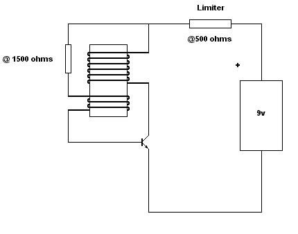

Hi Daviddoria,
Heres a bit more to contemplate.
In this arrangement any changes in current through the larger coil
cause currents in the smaller coil.
Currents in the smaller coil cause currents in the E-B junction.
The transistor alters its collector current, causing changes in the
larger coil.
A simple oscillator like this is almost guaranteed to work,
but without tuning it could be at any fairly high frequency.
When oscillating the current drawn from the battery will be low,
as the coils assume a high impedance to high frequencies.
If it doesnt oscillate, reverse either winding, it requires
positive feedback, the limiter will prevent damage.
More detailed explanations of oscillators can easily be found.
John

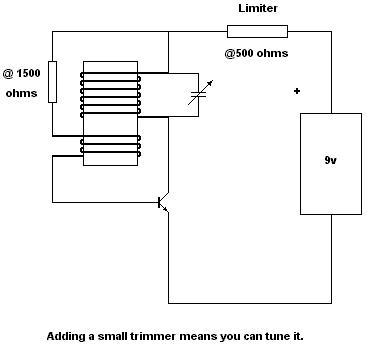

Hi Daviddoria,
By adding a small trimmer across the collector coil
the circuit now assumes the familiar appearance of
an LC tank and tickler.
The L & C form a resonating unit which determines
the frequency of oscillation.
There are many types of oscillator, a quick search
will bring up many.
To assist radiation (propagation) a small ariel can
be connected to the collector, or another winding
for it. The loading and propagation of radio waves
is a lengthy study of its own, but for a small low
power assembly like this, approximations should be
fine.
The reciever should also be tuned.
just making it the same will not do.
If you are going to make a small oscillator like
this, i suggest you do it in the same room as an
operating television. When its oscillating you
should see the patterns on the picture.
John

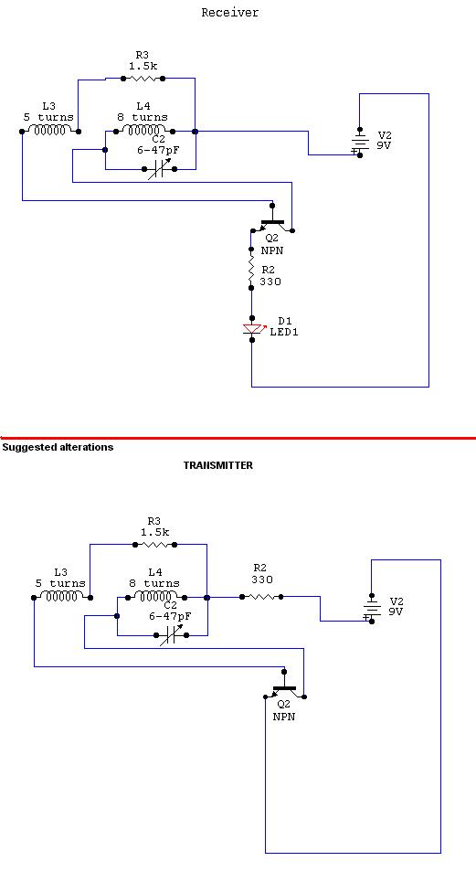

here are my new drawings (note my coils still in series (physics teacher suggestion, i'm sure you know more than him though :))
thanks guys
david

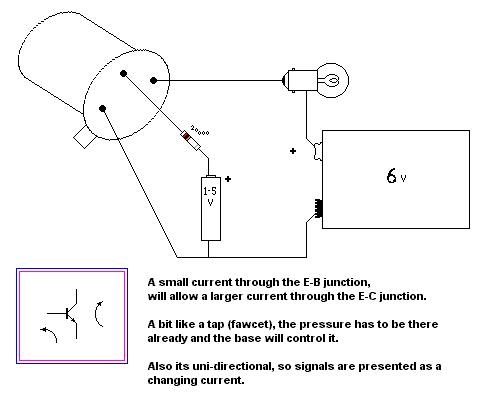

Could you give me a comment on my earlier post please?
The one with the transistor and the (lamp) bulb.
Cheers, John

john... i'm not sure i understand your bulb circuit, thats why i had not commented.
also, all 4 of my coils are 6 turns of 22 AWG wire around a 3/32 inch drill bit.
can you please explain what the 2nd coil in both circuits does and why it should be placed in series/parallel.
the only other thing is still why connect what you did to the collector and base.... do you have AIM or IRC or something where we could talk real time sometime in the next couple of days?

I am sorry i did not make the transistor and bulb example
very clear.
If you want to understand circuits, i will have to explain
the action of a transistor better.
That circuit is just an illustration to show that a small
current through the E-B junction allows a greater current
through the E-C junction.
This means that variations in a small current can be copied
in a larger current going through the collector, this is
called 'Gain'
A transistor with a gain of 20 would give a current change
20 times greater through the collector, from the current
through the base.
The little box in that drawing of the bulb and transistor
shows two little arrows.
Those arrows show the current paths, one through the base
and one through the collector.
If this is still not clear, i will try to explain it in
a different way.
Best of luck, John

i think i understand the receiver now, please have a look at
however, the transmitter i am a little confused still...
here is my understanding of a transistor:
a current is applied to the collector, but only let through to the emmiter when there is also a current applied to the base.
is that correct?
so in this receiver application.................
wait, while typing this i thought of something. am i understanding right which is receiver and which is transmitter? In my link above, if my receiver is even a receiver, won't my LED flicker at whatever freqency we are receiving at?
I would imagine we also need an oscilating circuit to receive an oscillated wave, but i am still confused.
hahaha
do you maybe have a link to a good page about this stuff... i can't seem to find anything this basic anywhere. everything i find about transmitting is extremely more involved than these circuits. they are all involving logic and transmitting codes and things like that. i will get into that eventually, but right now i just want to have an on/off type of receiver/transmitter.
thanks again

Hi David,
I found my way to that site, after a lot of 404s
It looks like you have the names backwards,
but the circuit looks workable,
providing that the two coils are together,
so that the one on the base,
can be influenced by the one in the collector.
Have you tried it?
John
Hi David,
Ive suggested a small alteration to your circuit,
which does look workable.
Have you tried it yet ?
John
