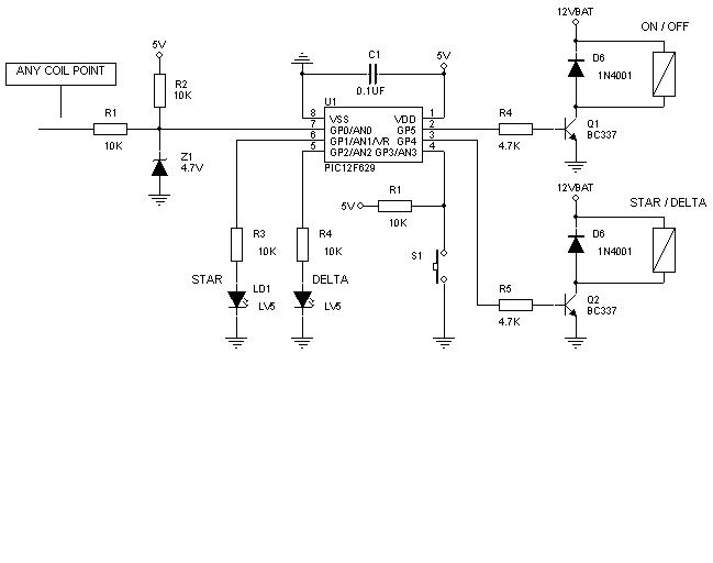

Hi Simon,
Considering all what people said, let me suggest one more simple solution in contrast with the circuit that you have posted in first place, and again, considering some cited aspects.
1. The rotation sensing is maded by viewing the wave/signal present in any point of any coil, before rectifiers. No more hall-efect sensor needed.
To make this work, the generator/battery disconnection must be made beetwen the bridge and battery.
2. I suggest 2 relays intead of one by two reasons:
a) When STAR relay is OFF -> STAR position, no battery discharge.
b) When ON / OFF relay is OFF -> generator is desconnected from bat and no bat consumption.
- So, when both relays off, just a few miliamps from battery.
3. With the KEY, you can configure:
a) The speed at wich the system switch from star to delta.
b) The speed at wich the system disconnect the generator.
c) If needed, you can have generator disconections to max and min speed.
4. You have also STAR/DELTA indication througt the Leds.
Notes:
1. Of course you need a little 78L05(+5V) to supply the PIC.
2. The software to do it, is very easy.
3. Sorry for duplicated references in the schematic.
Regards
Jolino

anybody else have any thoughts on the new circuit jolino ha put forward, it sounds as if it will be great. I think i can work out a 5volt power supply for it easy enough too.
Adjusting field current in a permagnet magnet rotor??
It appears that many respondends jumped on the bandwagon without bothering to read the links you posted, where it becomes obvious that there is NO field current to adjust with a permanent magnet rotor.
So you are right to ponder the star/delta question.
Nigel's reply gives you a good reason why bothering with that complication.
My practical suggestion is how to accomplish this:
Do the switching bit with a suitable relay.
Control the relay from a centrifugal switch.
You may salvage such a switch from any single pole squirrel cage AC motor, aka ex washing machine (not Fisher Paykel;-).
You may have to tinker with the centrifugal weigths to get the right switching time. To do this rig up the wind generator minus the blades and drive it from a suitable variable RPM source - if I had to do this I would use my lathe for the driving power.
The electronic 32 point switching module seems far too complicated for this application and I can't see why anybody would require so many switching points unless you plan to use variable geometry adjustable blades for your windmill.
Klaus
