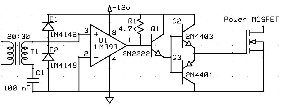

I have drawn a schematic for the drivers. T1 couples the driver to the oscillator and is clipped by diodes D1 and D2. U1 turns Q1 on which turns on Q2 and Q3 which drive the MOSFET gate. The power supplies are seperate to keep the drivers isolated. Would this drive the MOSFET gate with enough current to turn it on?

Don't use LM393. Use a "gate drive IC" to replace IC+Q1-3.
or
If you have to use the LM393; the (-) input should be at 6 volts or 1/2 supply. Add two resistors.
or
Remove LM393 + Q1. Drive the base of Q2,Q3 directly from the transformer.
If you do this you will find that the two diodes are in parallel with the B-C diodes in Q2,Q3. I have used this circuit with out the diodes, just using the B-C diodes.
If you want to use Q2, Q3 with out LM393 look at ZXGD3003E6. There are biger versions.

T1 is a homemade transformer wired with CAT-5 wire, it is not going to have the best signal, that is the reason for the 393. I will make a voltage devider for the (-) input on the LM393 with two 1K resistors. I would use a driver IC but I do not want to wait 3 weeks for E-bay and I also want to know how to do this with discrete components. I will try to drive the base of the transistors with the coupling transformer but I doubt that the signal will be good enough to drive the MOSFETs.
The IRF 21XX series of gate drive IC's could cure a lot of problems as well. Doing PWM through a gate drive transformer is common place in welder and plasma cutter power supplies but its not a simple process. Dedicated driver IC's are needed for the transformers and clamping circuitry is needed on the gates themselves.
