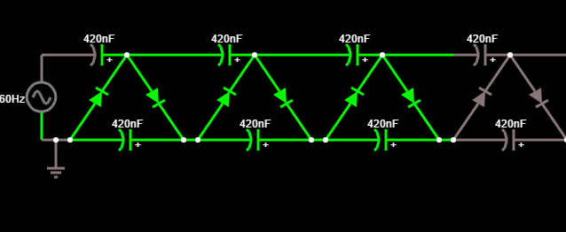

To add to this, I went into an an online circuit simulator and made this. This is all wired to have a positive output. I was fiddling around, but I could not figure out how to get the output's polarity negative.

Nice! I am planning on experiment with hydrogen, helium, and argon, at pressures form 1-10 millitorr. I am however using a diffusion pump.

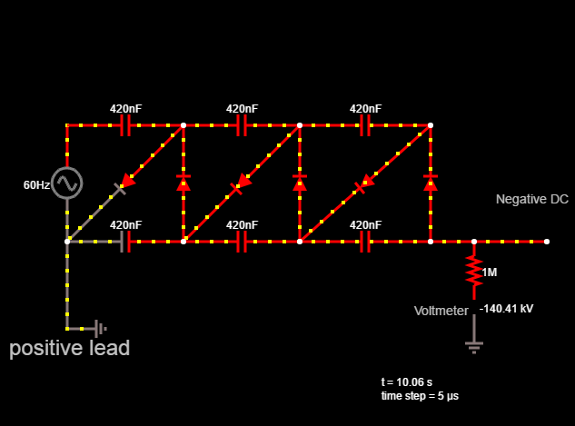

Well, I sure have become obsessed with designing this power supply now. After doing much more experiment in the simulator, and research, I finally figured out how to get a negative DC output. Here is the picture of the design in the simulator, along with what I plan on doing for voltage measurement.
This is with the AC input being 10kv. For whatever reason it is saying the voltage is unusually high. I believe this is an error

Well, I sure have become obsessed with designing this power supply now. After doing much more experiment in the simulator, and research, I finally figured out how to get a negative DC output. Here is the picture of the design in the simulator, along with what I plan on doing for voltage measurement.View attachment 103270

(PS: have a look at the power dissipation in the 1M resistor connected to the voltmeter.:)
https://www.digikey.co.uk/product-detail/en/ohmite/SM108035007FE/SM108FE-5000M-ND/824231)

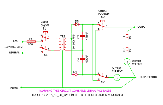

Hi Lash,
Below is a schematic showing a notional circuit for a 40KV EHT generator for your consideration.
spec.
NOTES
(1) The current through R1 and R2 will discharge the capacitors when the mains is removed.
(2) The peak to peak ripple voltage is defined by 166.6/C, where C (C1 and C2) is in uF. With C1 and C2 = 470nF the peak to peak ripple voltage will be 723V.
COMPONENTS
(1) Diodes are 40.4KV min, 40mA min. https://www.semtech.com/images/datasheet/schjxk.pdf
(2) Resistors are 20.2KV min, 2.2W min. https://www.digikey.co.uk/product-detail/en/ohmite/SM108035007FE/SM108FE-5000M-ND/824231
(3) Capacitors are 20.2 KV min. capacitors can be made up from any number of smaller capacitors in parallel.

From a person that has made many 40kv power supplies;
Where are you going to get 60kv diodes?
Parts like this are hard to find.
https://www.semtech.com/images/datasheet/sckvxk12.pdf
Hi Ron,
Yes, you are right. I meant the circuit to be conceptual rather than practical and should have made that clear. With a 60Hz mains frequency a practical design is a problem from a component view.
I recon that the diodes need to be 40.4KV minimum peak inverse voltage (PIV) rather than 60KV. The Semitech SCH45KV has a PIV of 45KV and should do the job. They were just the first diodes that showed after a quick web search. By the way, many of the extra high voltage diodes are, in fact, lower voltage diodes connected in series in an encasing tube.
The main problem, from a cost point of view, are the two reservoir capacitors.
