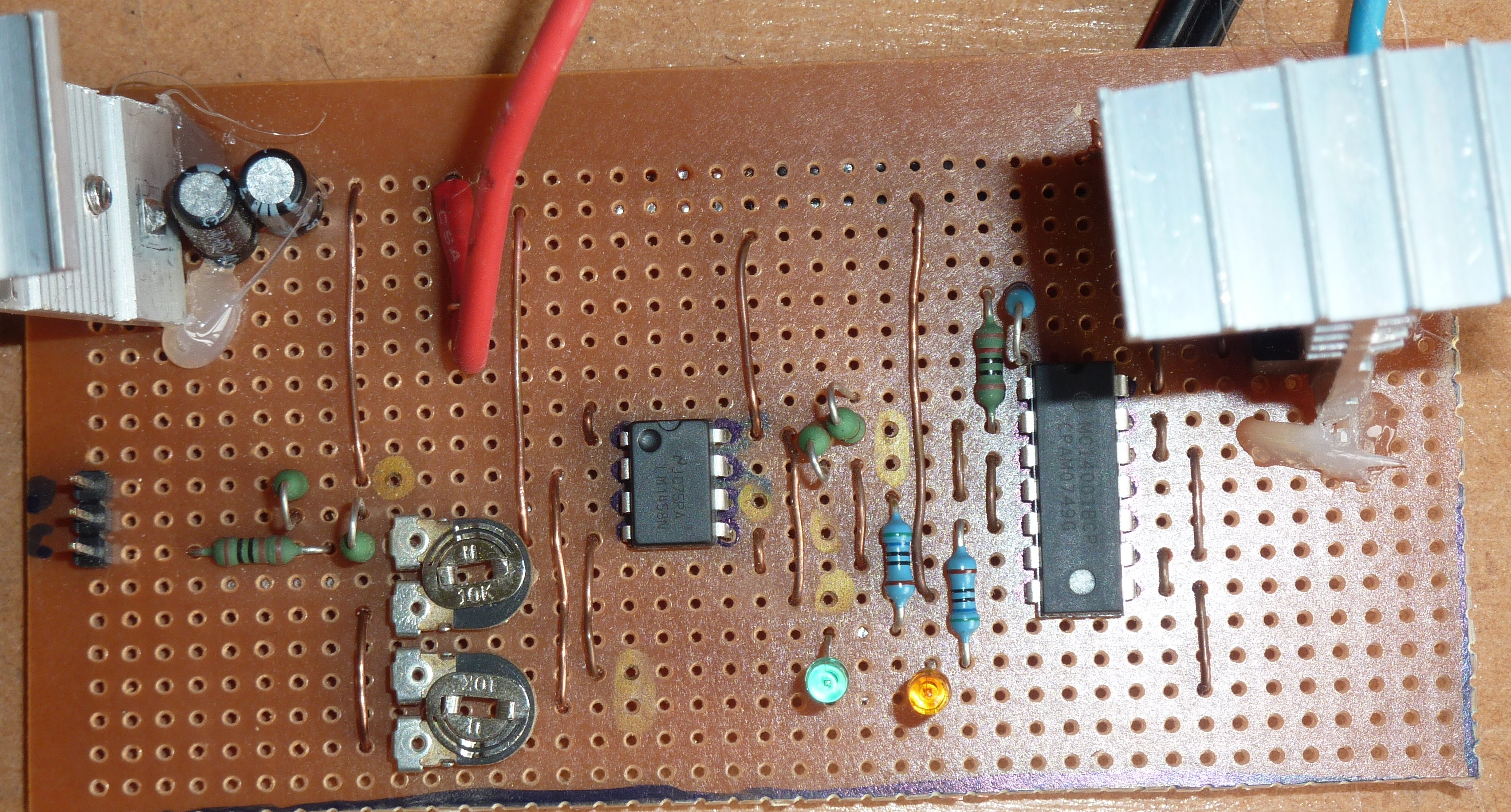

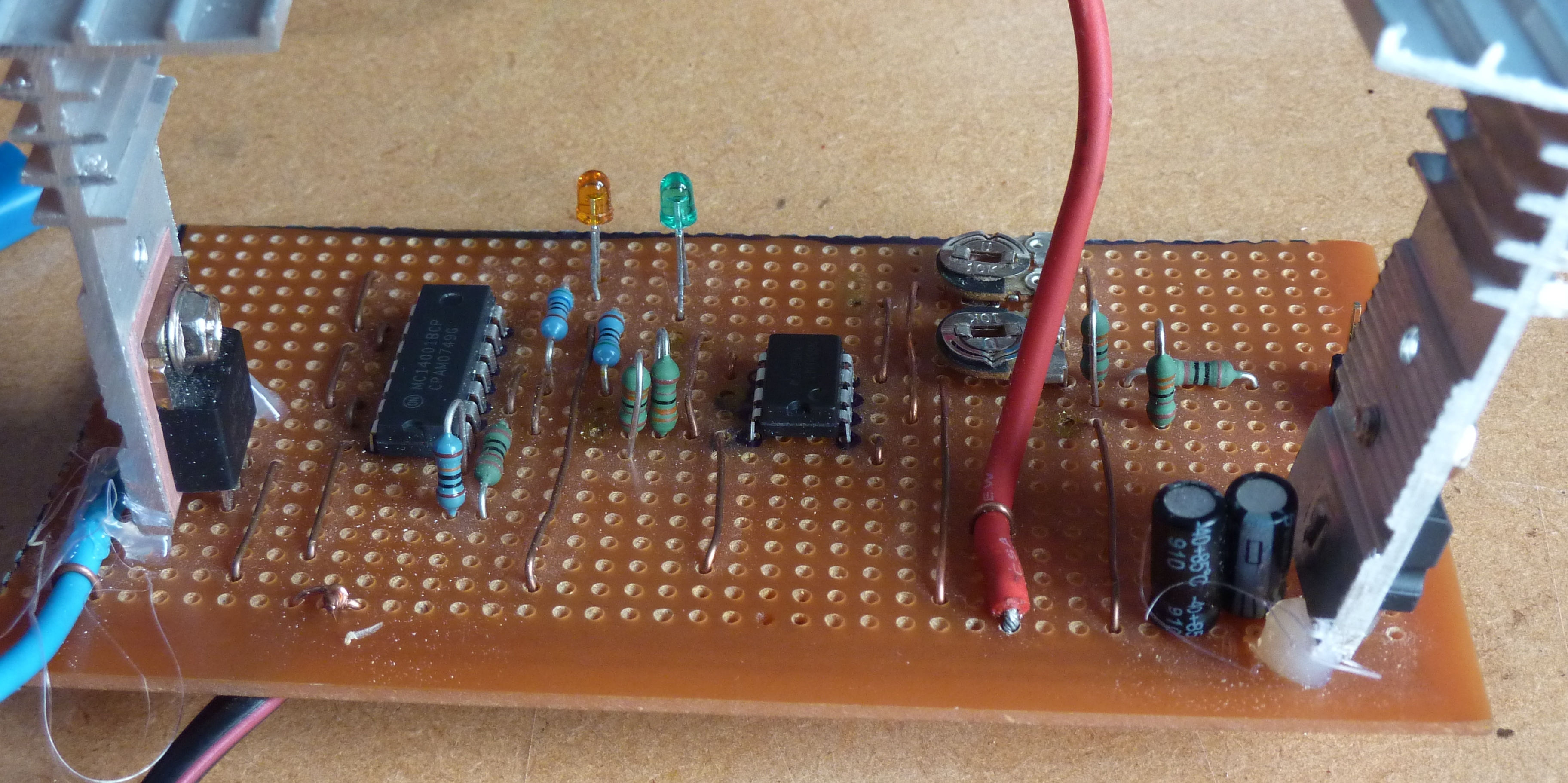

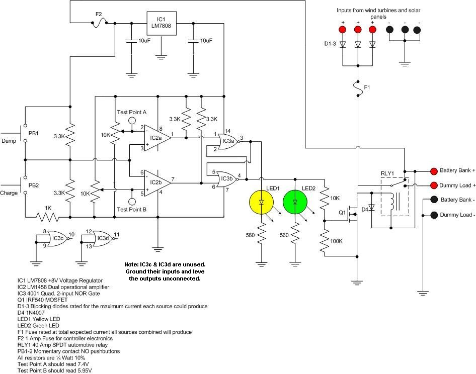

I have built a diy charge controller from the schematic attached and it will not charge the battery. I have it connected to a 12v supply and when I short the header (instead of adding buttons) to force it to charge it only turns the dump led off and not the mosfet and it doesn't turn the charge led on.
Any ideas?

I haven't built this circuit, but may I suggest connecting the relay coil from the MOSFET to the main power source. The DUMP feature should drain the battery, not inject it with an electrical surge.
The dump feature connects the windmill to a load other than the battery so that it doesn't spin out of control and self destruct. It doesn't inject it with a surge of power it merely disconnects the battery to prevent over charging.
I have fixed the problem in the original post and the unit is now working fine and has been for a month or two now. There were a number of problems, a solder bridge on one of the trimpots and i had a p channel fet instead of a n channel and i had missed out a track cut.
see https://www.thebackshed.com/Windmill/forum1/forum_posts.asp?TID=2925&KW=terrapinlogo&PN=0&TPN=1 for the whole story
I would be incline to move fuse F1 to battery leg on other side of relay as the result of it blowing could be a windmill run away where it is presently at. No fuse in line to load dump.
Modify circuit so detection of blown fuse on battery line automatically moves to load dump.
