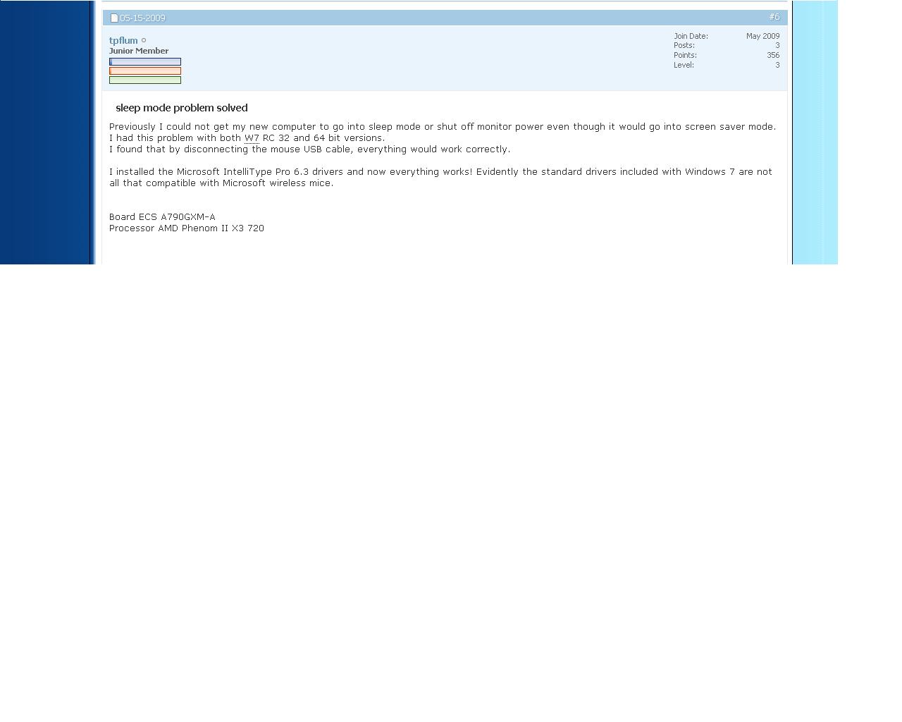

Might be a driver issue? Apparently this guy found out that the drivers to the usb mouse was messing things up. So, he used some Microsoft ones and that solved it.
Not clear enough here is the URL **broken link removed**

Thanks KV! The keyboard and mouse driver updates did the trick. :)
We never considered that Microsofts hardware and software might not be 100% compatible right out of the box. :eek:
Now I have mouse functions and keyboard buttons that actually do what the little pictures show for the first time ever! :D
Oh ya and the monitors actually shut off when they are supposed to now. :)
