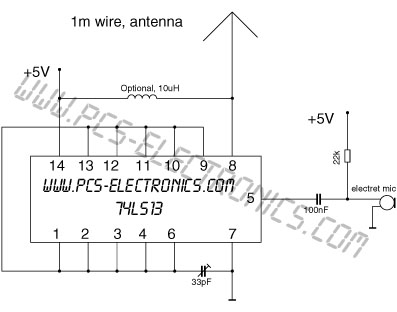

wondering if this schematic works
whiz115
and what's the positives and negatives if you compare it with a colpitts
1 transistor FM transmitter?
thanks

atleast it oscillates right?
from my stand point as a newbie i believe it's pointless since the same job can be done with a single transistor which uses much less space...
but i don't know if it is more stable than a transistor oscillator...
probably not because in case you aproach the antenna you'll add
directly to the oscillator and the frequency will change.

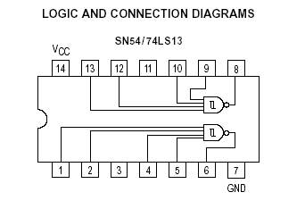

So far no one's said why it's rubbish.
It's a crappy circuit because it produces a squarewave which is rich in harmonics and will spread interferance all over the radio spectrum.
Aside from that, pin usage on the chip appear to be all wrong. Mic inputs to nand gate but output of gate is tied to some quasi funky common of all pins. Circuit is just, well not right.
I do not see how this thing could have worked at all.

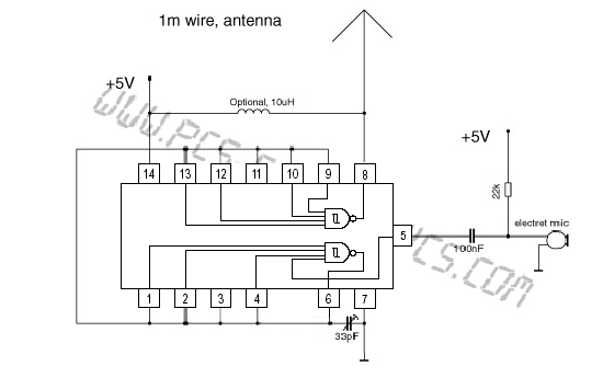

Here's the schematic with the gates.
It looks like it will oscillate but I can't see it having an FM. I don't know may be the Schmitt trigger thresholds might change if the voltage on a neighbouring input is varied?
It certainly is a rubbish circuit and will produce lots of harmonics.
