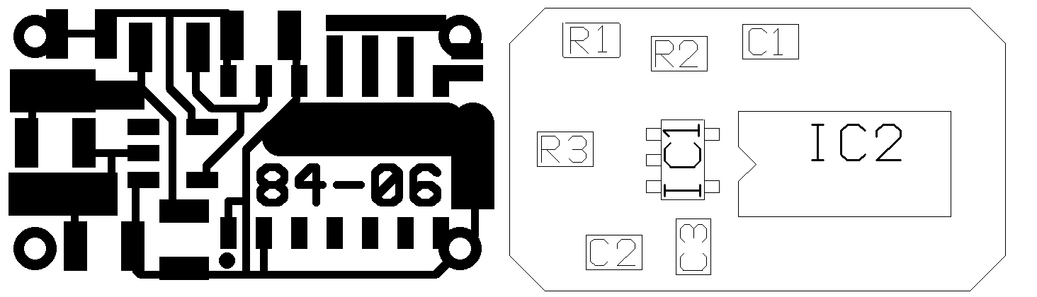

This is a design that I have used. You can miss out the divider. I agree with Reloadron that it is far easier to use a complete oscillator.
This uses UM-1 crystals, with a 30 pF load.
Crystal
Freq 12-20 MHz
R1 Omit
R2 link
R3 1M
C1 10,000pF
C2 47pF S.O.T.
C3 68pF
IC1 TC7SU04F 108-5252 from Farnell 74HC1GU04GW RoHS Compliant
IC2 74HCT393D
Divide ratio Pin to link to output
2 11
4 10
8 9
16 8
