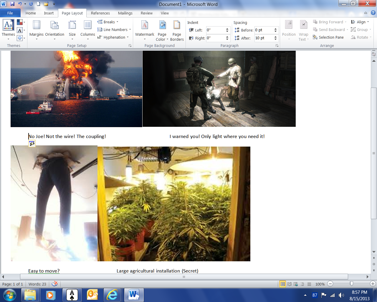

I can assure you this will not happen. Its perfectly safe. In fact, even if you stripped the bus insulation and touched the bare wire, the 50KHz electricity sees the human body as a high impedance so, you'll be ok.....i"Soter"A.....Soter is the Greek God of Safety. "i" and "A" mean current...so its "safe current".
Seriously, watch this space, because "they" (you know who), are just commencing a large installation in a brand new office block....its a big block. I'm fascinated to see how it goes on. The office block looks very smart....its more "wide are sprawling" than "high rise", but i only saw the picture briefly.

By the way, a local bank recently moved their customer service desk 1 metre to the right so that customers queuing for it weren’t near a door to which staff access was needed.
The LED downlight which had been above the customer service desk was obviously now 1 metre away from where it now needed to be for the new location of the customer service desk. This downlight was mains connected.
The customer service guy offered to simply get stepladders, disconnect the mains for 10 minutes, and disconnect the downlight and move it to the adjacent ceiling panel , and then re-wire it in there. However, his manager said no, due to health and safety reasons no staff were allowed to work on mains electricity, and thus an electrician would need to be called.
The electrician was called, of course, out of hours, as this couldn’t be done whilst customers were there. The Electrician bill came to £510………and that was just to move a mains downlight one metre to the left, to the adjacent ceiling panel there.
If they had had a High Frequency Alternating Current (HFAC) lighting system, they would not have needed the electrician, and could have just painlessly and simply done the job themselves.
Think of how many Government Buildings etc there are where taxpayers money has been spent on electricians to do thousands of similar jobs. This wouldn’t be needed if they had a High Frequency Alternating Current (HFAC) lighting system from companies like i*****a.
They could have done it IF the hfac wiring was already in place where the light was needed.
From what I know about large corporate organisations, I'd bet my lunch that staff still wouldn't be allowed to move the wiring and an electrician would still be called. Also, those ceiling panels aren't supposed to support anything. So in such a situation, where is your hfac wiring going to be attached? If staff did simply clip on an extra length, chances are it would be attached somewhere inappropriate, resulting, eventually, in a sagging panel over the service desk.
Also, the case is an exception rather than the norm. It is rare to need to move an odd light like that, so the capital cost of the system would outweigh the benefit of being able to move a light once in a blue moon
The system in question is an interesting idea that is not really common and mainstream, which is something I certainly like. But to claim it will revolutionize everything is a blatant exaggeration, not that I have never exaggerated before. :D

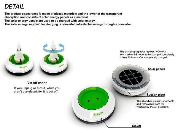

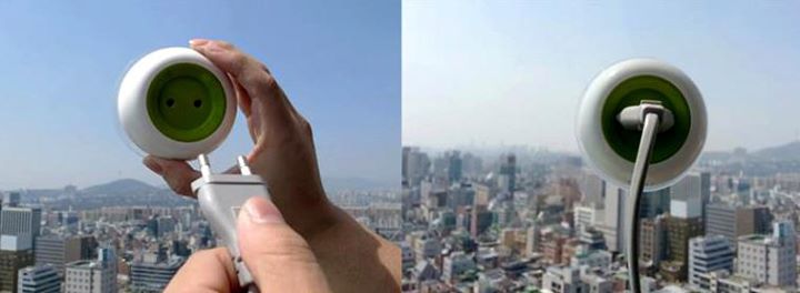

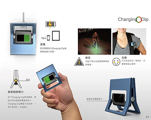

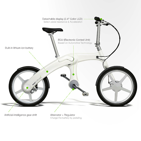

I bet this is not a product, it's just an Industrial Design Proposal. And proposals like this are the reason why sometimes I feel ashamed of my career.
It's very common to see how some Industrial Designers only think about the Form and forget about the Function. They overlook the most basic scientific principles, arguing "That's not my field, an Engineer will take care of it".
At the end of the day you get this:
#3 Charging my device via magical means
#2 Use the power of the sun to power your toaster (they even include mAh specs!)
21320_592937220731153_1034385845_n.jpg 11906_592937407397801_2058194200_n.jpg
And #1, my favorite, The chainless bicycle were the pedaling energy is stored into a battery, and then the battery feeds an electric motor connected to the wheel. And also powers an LCD Display. Why not using a chain? Because "Chains are so ugly, yuck!"
Obviously I'm not saying that all Industrial Designers think in that stupid way, there are brilliant examples like Dieter Rams. But unless the other "purely aesthetical" Designers change their mentality, one will keep hearing phases like "who cares if it doesn't work yet, that 3D Render looks sweet!
