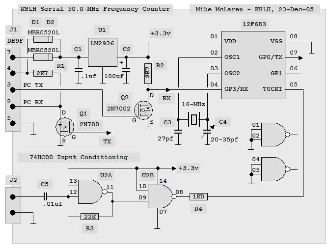

Wow Mike that empty the prescaler routine is very cool, I'm not sure but are you gating TMR0 using the TRIS? This would mean some form of hardware buffer on the pin as your making an input into a output.
Use a 1K resistor on the T0CKI input as a "load" for your frequency counter input conditioning circuitry when T0CKI is an output (R4 in the example below)...

It also occured to me on chips with an open collector RA4 it wouldn't matter if you made the pin an output and pulled it high.
I wonder how fast the comparators are? can they do 50MHz?
