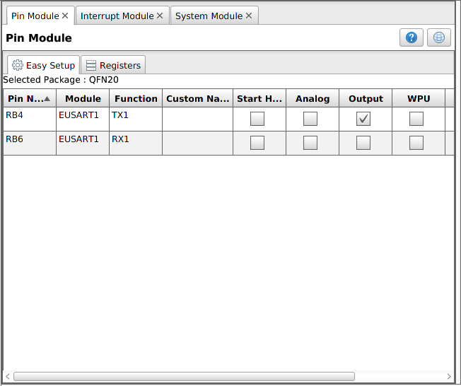

Are the Rx and Tx pin assignments in your program correct? The schematic suggests RB6 should be the Rx input and RB4 should be the Tx output.

'Module: EUSART1
RB4PPS = 0x000F 'TX1 > RB4

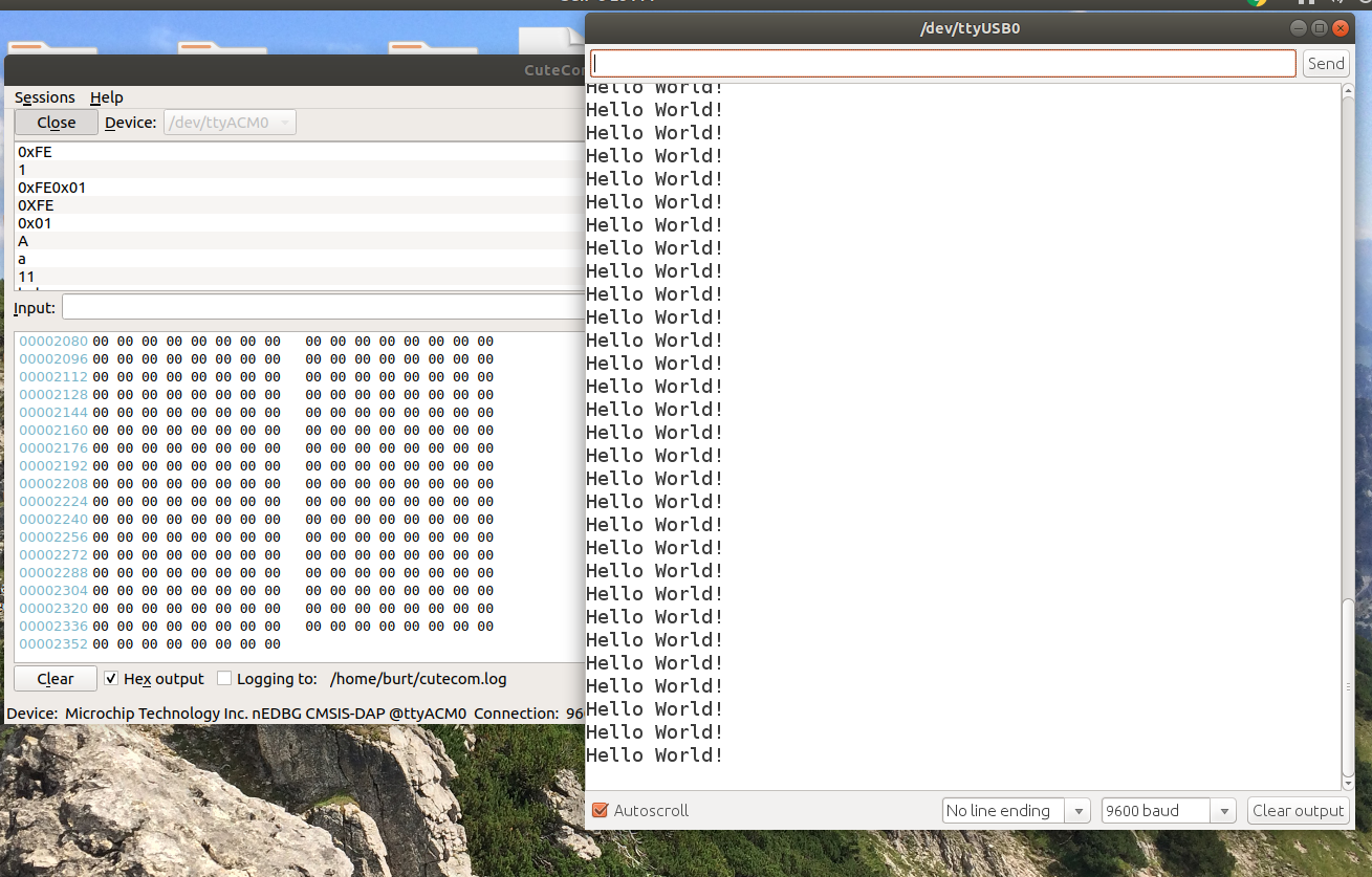

Sorry but
Nothing is showing
Think I posted wrong file I had tried both ways rx to rx and rx to tx just in case but i get nothing
use a off board adapter it works fine im just use it without the on board serial
Mike - K8LH this is what i have and I'm using RB4 as TX
The picture shows the output of the nEDBG on ttyACM0 it's all 00
I have a Usb to serial on ttyUSB using the same pins it output is on the right
But the CDC nEDBG has someting wrong in setup
Windows 10 I can get the same output using realterm
