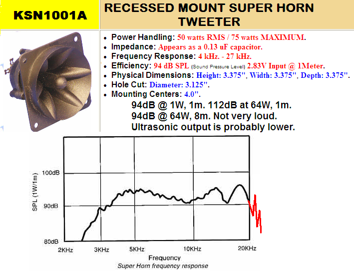

Many years ago, Motorola made piezo tweeters that were powerful and had a response up into ultrasonic frequencies. Then they sold that business to CTS and a few companies sell the tweeters.
Here is a link from Google: https://www.usspeaker.com/cts index-1.htm
The frequency response of a piezo tweeter is many peaks and valleys. You need to feed it at the frequency of a peak, somehow or use a frequency sweep.

You are correct sir. Now can you tell me what kind of tweeter will work for what I am trying to create, & where they can be purchased?
