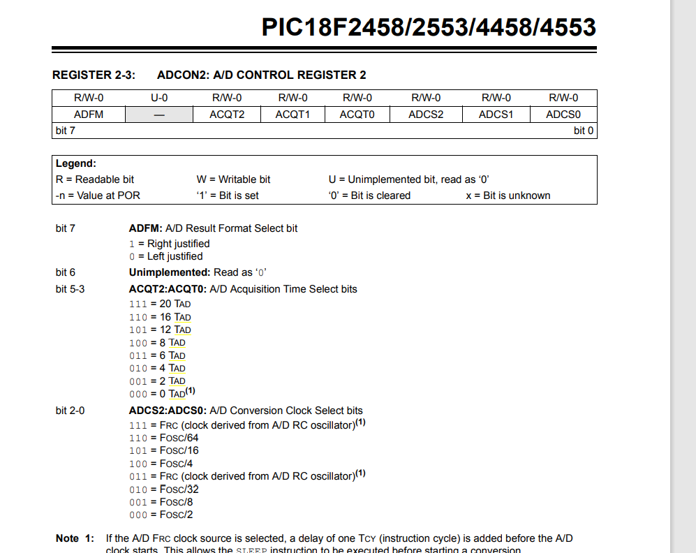

Does the Adc_read function have the required acquisition time?
Pommie
I didn't get what you mean, I'm not sure if the ADC_READ have that timing, it's a library in MikroC.
But how is that related to my problem ?
I think I have a problem because other ADC values are read and there are no sensors input, and I'm sending them as a packet... by USB
If you're getting cross talk between ADC channels then it's normally due to too short an acquisition time.

Without proper comments or reading the datasheet, I've still no idea if the acquisition time is adequate. What is your acquisition time?
I have used the following configuration according the data sheet
FOSC/32, 12 TAD
I still get cross talk

It's nothing to do with a acquisition time - it's a VERY well known and common 'problem'.
It's simply that when you change analogue channels you have to wait while the capacitor in the sample and hold charges/discharges and settles to the new value. The time this takes is heavily dependent on the source impedance - with the maximum suggested value only 2.5K or so.
So you need to add delays to give that time to occur.

By adding it there you're adding the delay every time you read the ADC, including when you haven't actually changed channels - so as you're calling that routine 16 times, you're wasting 15 of the delays. You need to separate the channel selection and the reading routines, so you call the channel selection once, and the reading 16 times.
The datasheet seems pretty vague about the source impedance?. But I'd certainly try far higher delays than 1mS and see what happens.
Or you could measure the output impedance?.
Apply power and ground to the sensor, with nothing on the output - set the sensor to midway, and measure the output voltage - write it down!.
Next connect a 1K resistor between output and ground, and measure the voltage again - presumably it will be lower?. You can then use ohms law to work out the source impedance.
