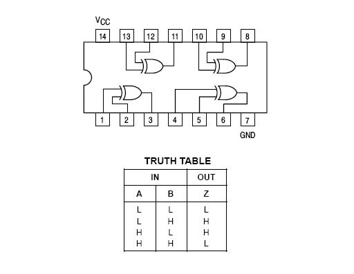

Im trying to get the above chip to work but without any luck, probably something simple that Im missing. Looking at the data sheet for the chip I have all the pins sorted, 7 to ground, 5 volts to 14 and using pins 1 & 2 for inputs. However I can't get any change out of pin 3 (output) no matter what I do with pins 1 & 2. From what I understand if either of the inputs goes high, pin 3 will go high otherwise remain low. What voltage does either of the input pins require to be classed as high ? Is there a straight forward way to test the chip.
Many thanks for any help

yes either input can go high but not both...
did you try grounding one of the inputs and let the other one float high

I tried that and got 0 volts from pin 3, then let both float and got 0.2 volts from pin 3. From further reading I gather when the output pin goes high I should get 5 volts, could the chip be damaged ?
The logic inputs need always definite levels. Connect one input to GND, another to +5V. Floating inputs most of case high level.

you have three other gates on that chip.. try another one..
I may have the answer : Upon reviewing the data sheet again I see the output low voltage is 8mA and output high voltage is -0.4mA. Does this explain the readings I was getting, if so apologies for not spotting this sooner ?

No, those are not voltages, those are the currents that an output can sink (output low) or source (output high) respectively, and still maintain a valid logic level. If you really have pin 14 to +5V and pin 7 to GND, and you connect one of the inputs to +5V and the other to GND, the output should go high (around 4V). If you connect both inputs to GND, or both inputs to +5V, the output should go low (around 0.2V). The reason for the current specs you mentioned is that TTL circuits draw current on their inputs, so there is a limit to how many TTL loads you can drive with a given output and still maintain valid logic levels.
Have tried again with this chip and still the same result, I am seriously begining to think I may have inadvertantly damaged it somehow, possibly burnt it out. I will take a trip to the store tomorrow and purchase some replacements and try again.
Many thanks for all the help given.
I will post my progress with the new chips in due course
Success! The new chips worked perfectly. Many thanks again to everyone who answered my query.
