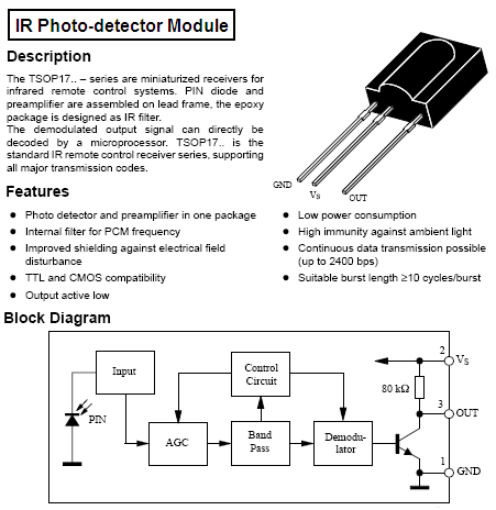

Why not use a TSOP IR receiver IC instead of re-inventing the wheel?
I want to implement multiples of this reciever circuit. so it has to be cost effective. ( i am also tryin to replace the AD817AN with a cheaper op-amp.. i used it cuz it was handy and it sufficed the rquirements)

Your very low gain circuit barely works as "FAR" away as only 5cm. Is that anywhere near as good as a modern TV's remote that uses a TSOP IR receiver IC for its 10m range?
Sorry my fault, i must have been more specific. I thought i had written too much already.
The range i require is only 5 cm.
I am transmitting unique ID's:
10us on, 10 us off - ID 1
10us on, 20 us off- ID 2
and so on..
At the moment i am just simply turnin the transmitter on and off with a fixed "on" period an duty cycle. It is controlled by a simple program toggling the pins of a micro which is controlling the mosfet to the transmitter LED.
Photoreciever modules work on carrier frequencies, which would mean i would have to modulate my transmitted signal with a carrier frequency.
so using a module would mean i wld have to shift away from the workings i have until now.
Or is it an easy shift?
