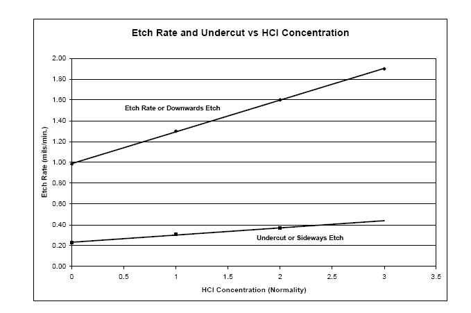

I suspect most of the information on under cutting is purely empirical. Chemcut, a maker of commercial PCB etching equipment, has a very good technical note. See:
https://www.electro-tech-online.com/custompdfs/2009/02/cupric-chloride.pdf
Here is one chart from that note:
etch-rate-gif.26124
Since the HCl concentration in the peroxide method may be quite high, or perhaps harder to control, I would expect variation in the extent of undercutting as your initial solution is used multiple times. That is not to say HCl concentration cannot be controlled, but I suspect few hobbyists do that. Of course, using fresh solutions each time also controls the acidity, once you get your formula right. Ferric chloride and cupric chloride may simply allow higher chloride concentrations without corresponding increases in the H+ concentrations.

jpanhalt, I'm not sure I understand the graph 1/1 ... It shows that increasing the HCL concentration in the solution will increase the speed of etching, but from what I can tell from first hand experience, more H2O2, more etching speed ?!?!?!
Anyhow, from what I can tell, there is no real reason for moving to another etching solution.
The text for the graph explains a bit more what it is supposed to show.

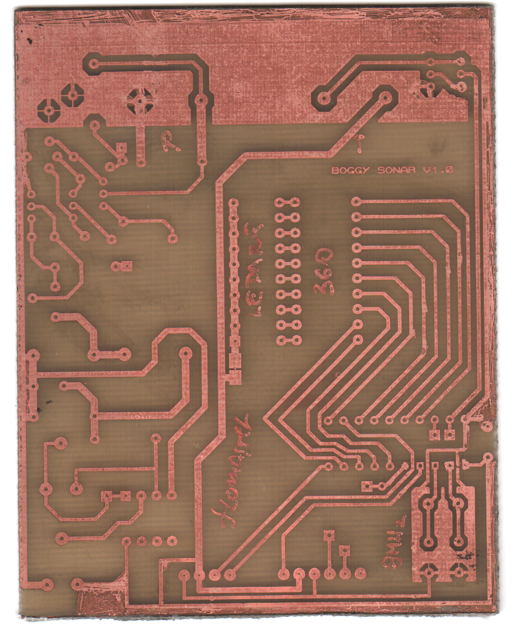

Here is one old PCB etched with HCl + H2O2 (this is actually the first ever board I did using blue press 'n' peal foil.. The board was not clean enough so I had to retush the board with a marker ... I used CD marker and the results were awful :( (as you can see) ... but, you can see how the etching solution did the job ... (pic is 2M 300dpi png)
