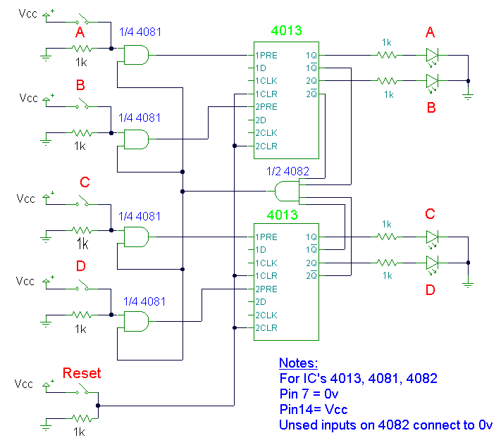

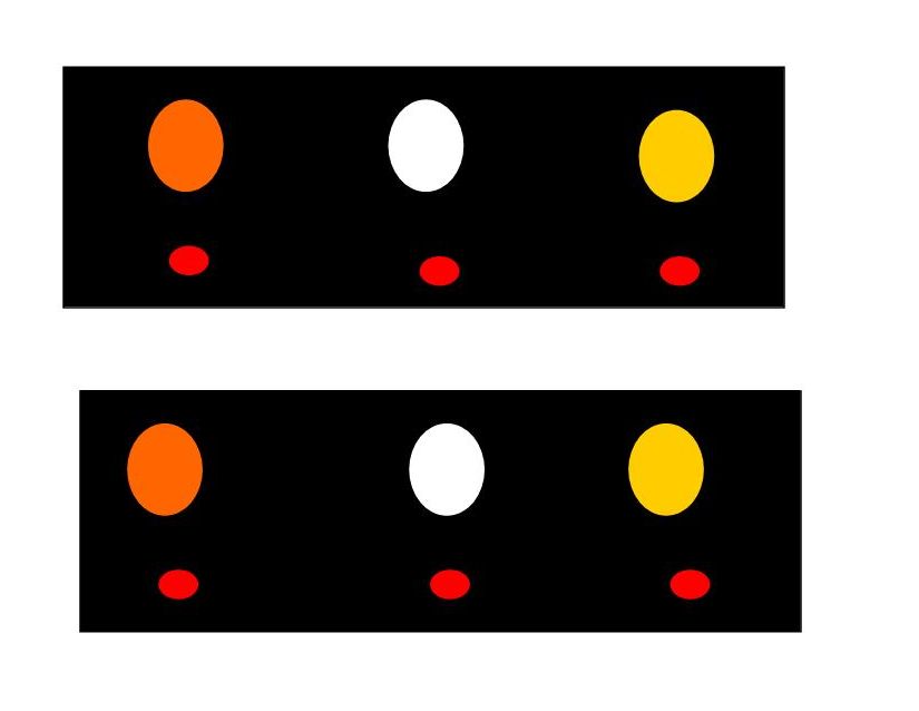

Here i am again dont know what to say but please some kind person help me before i go in sane. I have included two pics of what i am trying to do. one is of the boxes i have made with push buttons on them and 12 volt trailer lights. 3 of each on each box.
I have tried to make the circuit which i have also included but call me dump have no sucsess of making it not sure on where the poz and neg of the 12 volt transformer goes into the circuit. So if there is any kind hearted person out there that can help me out with either showing me a simplar quiz circut to build or can simplifiy the circuit diagrame and show me what goes where etc.. that would be most appriciated.

Please can anyone help me by either showing me another circuit simplar to build or can detail the circuit i have included keeping in mind that the trailer lights are 12 volt.

You will need a 12 volt DC power supply, not just a transformer. The notes on your schematic tell you where to hook up the power wires.
You have not said what you want the circuit to do. Please be more clear and I would be glad to help you.
12 volt quiz for triva nights
its for a quiz night and i have got a 12 volt dc adaptor that i will be using for the power of the circuit.
what i want it for is to ask questions and the first person to push their button their light lights up etc.. and blocks everyone else out of lighting their light up.
Search the internet for data sheets on those chips. That schematic doesn’t give pin numbers for anything. The data sheets will tell you where + and – go and everything else.
