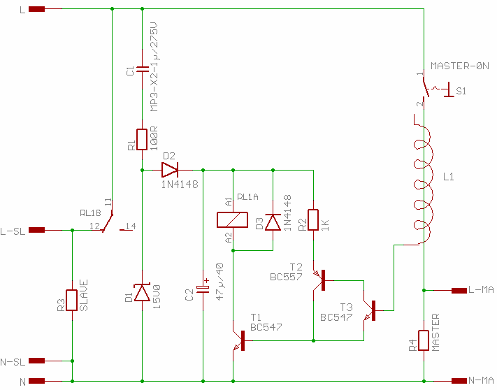

Here is a transformerless version.
L1 is a kind of 'antenna' sensing the electric field around the cable to the master device. T1 through T3 make a 'super transistor' activating the relay when the electric field is sensed.
Make L1 using 5 to 10 turns of stranded isolated wire wound around the master cable.
To reverse the function of the circuit connect the slave load to terminal 14 of the relay.

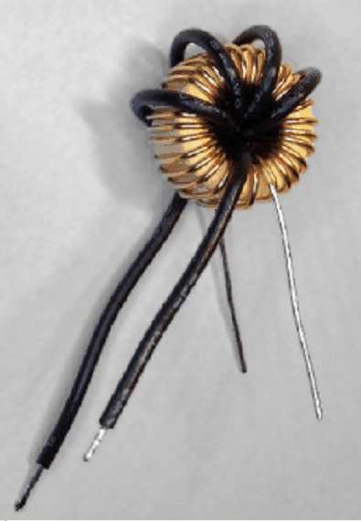

So wrapping 5 to 10 turns around a wire inside your house circuit breaker panel can make a current sensing xformer for much less than Grainger wants.

this is a current sensing transformer. The black wire is the secondary side. Current flows across the enamelled copper wire.

L1 is disconnected at the top end in your diagram. Is this really a capacitively coupled voltage sensor or a typo?
As long as you wrap around a power lead... Most house wiring includes a power lead and a ground return path, wrapping around both in the typical wire casing should cancel eachother's EMF to effectively zero. If you wrap around only a power lead (typically black), then yes, you can get the desired effect.
Hmmm, good Q. It might work as drawn with sufficient current through an AC circuit. Otherwise, I'd think it'd have to connect to ground as a typical transformer?
L1 represents an antenna receiving the electric field around the supply wire. So only one end has to be connected.

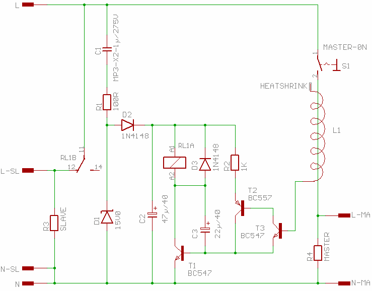

Master-slave-circuit
The sensor wire around the master cable is not a transformer. The transistors connected to the wire are high impendance amplifiers. The sensed voltage is rectified at the base-emitter junctions and charges C3. (not included in the preceeding picture)
Sensitivity might be adapted by changing the value of R2.
Life and Neutral must not be changed. Otherwise the relay might be activated at all times. Also, if a single pole switch is used for the master life must be switched. Switching neutral has no effect.
Boncuk

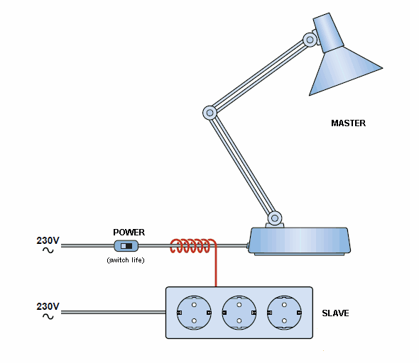

Here is the revised circuit and a picture how to connect components.
To prevent electric shock isolate the open end of the "coil" using heatshrink.
