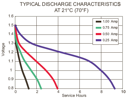

Plus and minus 15V is a total of 30v. You want the output to be 100mA so the output power is 3W.
Four AA alkaline cells produce 6V when they are brand new. A voltage stepup circuit might have an efficieny of 80% so the power from battery is 3.75W. The current in the AA cells is 3.75W/6V= 625mA and their voltage will drop to 4.8V in less than 1 hour.

Yikes. Thanks for the reality check.
