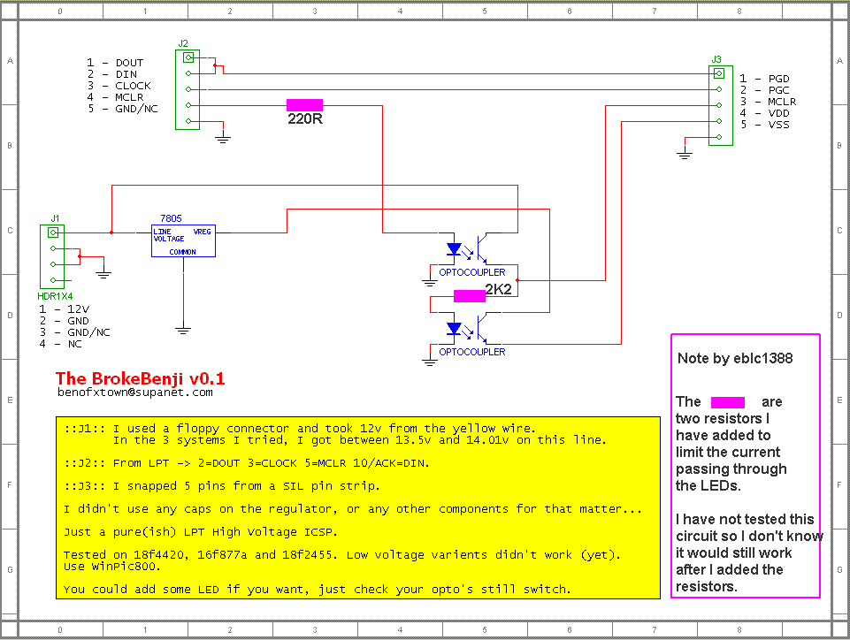

Hi everyone,
I found the following from the Microchip discussion forum. The original thread is here:
New LPT programmer
On first look the circuit is very interesting as it use very few components. I have modified the circuit a bit by adding two resistors. You may also use the 78L05 instead of the 7805 voltage regulator. In addition, I would also use two capacitors(not shown) for the voltage regulator as kind of good practice. If it does not work, you can remove them and try the original circuit.
I just wonder with the original circuit, PIC's MCLR pin voltage can never rise above the LED forward voltage drop of 2.0V, how it would work in this case. Not to mention the high current that would kill both the opto-couplers.
If you ever tried to build it, please post back to let us know of the result.

As you say, the original can't possibly work - there's probably not enough current available from the parallel port to blow the LED?, but it won't do the port any good!. As you also say, the second opto-coupler prevents MCLR from rising above 2V or so.
The two resistors you added might make it workable, and I would also add a couple of capacitors round the voltage regulator. Bear in mind, assuming it does work?, it will require a fairly accurate and stable supply voltage (as there's no MCLR regulation incorporated).

In the original circuit, the parallel port MCLR connection should have enough current to light up the top optocoupler which then switch the +12V or more to the LED of the bottom optocoupler without any current limiting. This would possibly destroy them both.

Depends on the transfer rate of the optocoupler, but regardless - it won't work :lol:

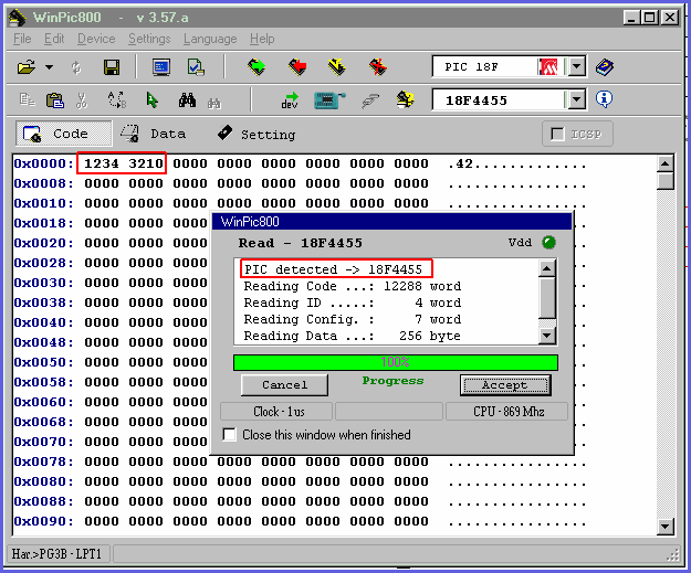

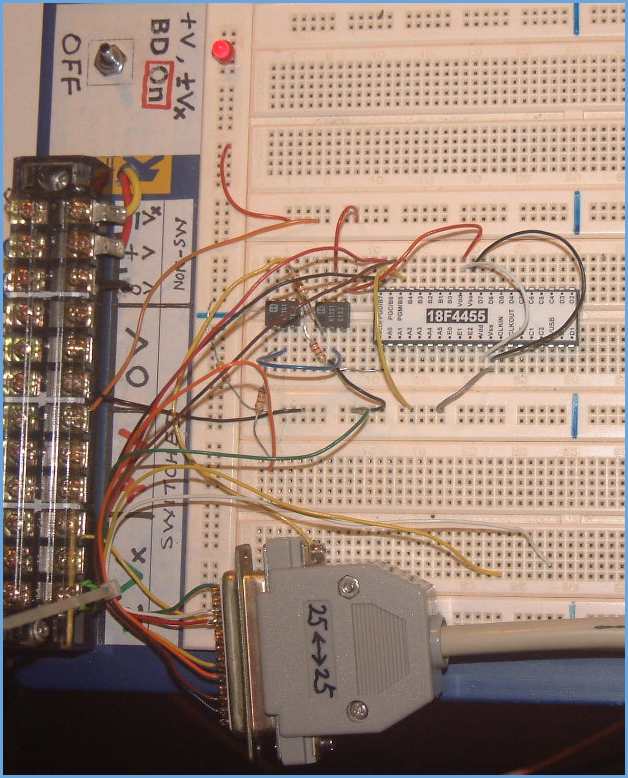

I have good news to report.

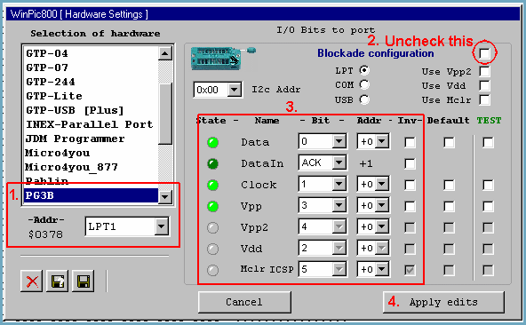

The circuit works without doubt and I have photos to prove it. I have used two H11G1 optocouplers as I have them in my part box. I guess many other types can be used too as the timing is not at all critical.
Please note that I am using my modified circuit with the two resistors added and because my bench supply has +5V output, I get it there instead. This should make no difference between using one or a 78L05.
The voltages provided by my regulated supply are +12V and +5V exactly.
The operation was tested on a 18F4455 which I have previously programmed "1234" as the first word so I can use it to test my other programmers. The "3210" next to it is the actual data I programmed into the PIC using this setup. All went well.

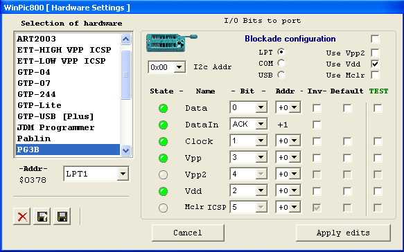

To save you time in setting up the software WinPic800, I have included the setup page. Note the signal pins used is exactly what were said in the schematic. PC operating system is Win98SE.
All in all a simple and useful circuit for programming PICs. All credits to creator of BrokeBenji, whoever he is.
Have fun. If you get yours working, remember to post back for others to share your experience or circuit improvement.

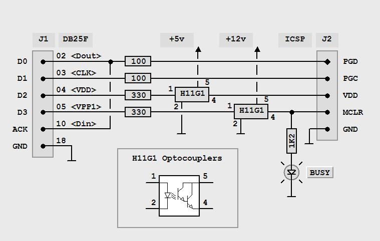

Question please? Why not feed the 'VDD' opto-isolator from the D2 pin on the parallel port? Isn't this pin normally used for VDD switching by many Tait style programmers anyway? It seems this would allow the smarter programming software to apply the correct VPP-first or VDD-first algorithm as necessary to put the target device into high voltage program/verify mode...
Regards, Mike
Yes you can separate them but I believe that the Vdd first device would still work even in Vpp first mode. The converse is definitely not true. I have no proof and have not tried any.

Yes, it should act like a pull-down... I went back to my drawing and added a 'Busy' LED and 1K2 resistor to provide the same function...
That WinPIC800 program looks pretty decent... I'll have to order some optocouplers (grin)...

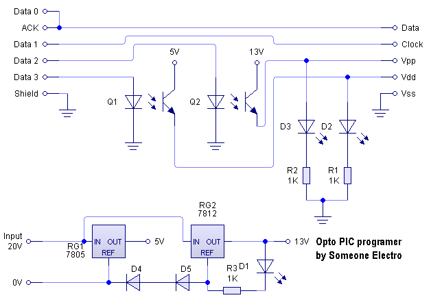

I made the programer whith a litle mod to it.First i tock one data pin to the second opto and added status LEDs on the Vpp and Vdd. Also an ptity power on LED and and regulated 13V rail becuse i have an 16V wall wart that outputs near 20V open cirucit (Ok you can call me LED crazy)
It programed an 16F88 fine.Im yet to test it on some other PICs.If this goes well im gona solder it all togeter.And i hope it goes well.

Ok here is my opto PIC programer.
It uses the LPTs curent limiting so no resistors on the optos.
Settings are almost the same
Tested and works on:
PIC16F88
PIC16F876A
PIC12F675
PIC18F4550
