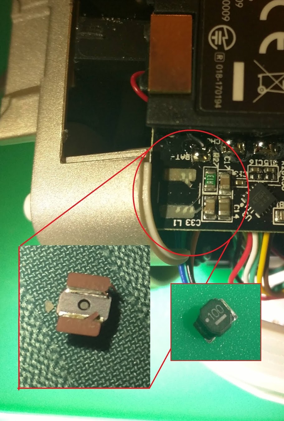

Any idea what this fella is? It fell off and im trying to find out what it is, and if I can repair it... thanks in advance!

100uH inductor. (could be 10uH) It is probably good.
Looks like the traces are ripped off the board.
You'll have more success trying to connect wires to the caps & resistors that those traces were routed to rather than trying to reconnect the broken traces.
