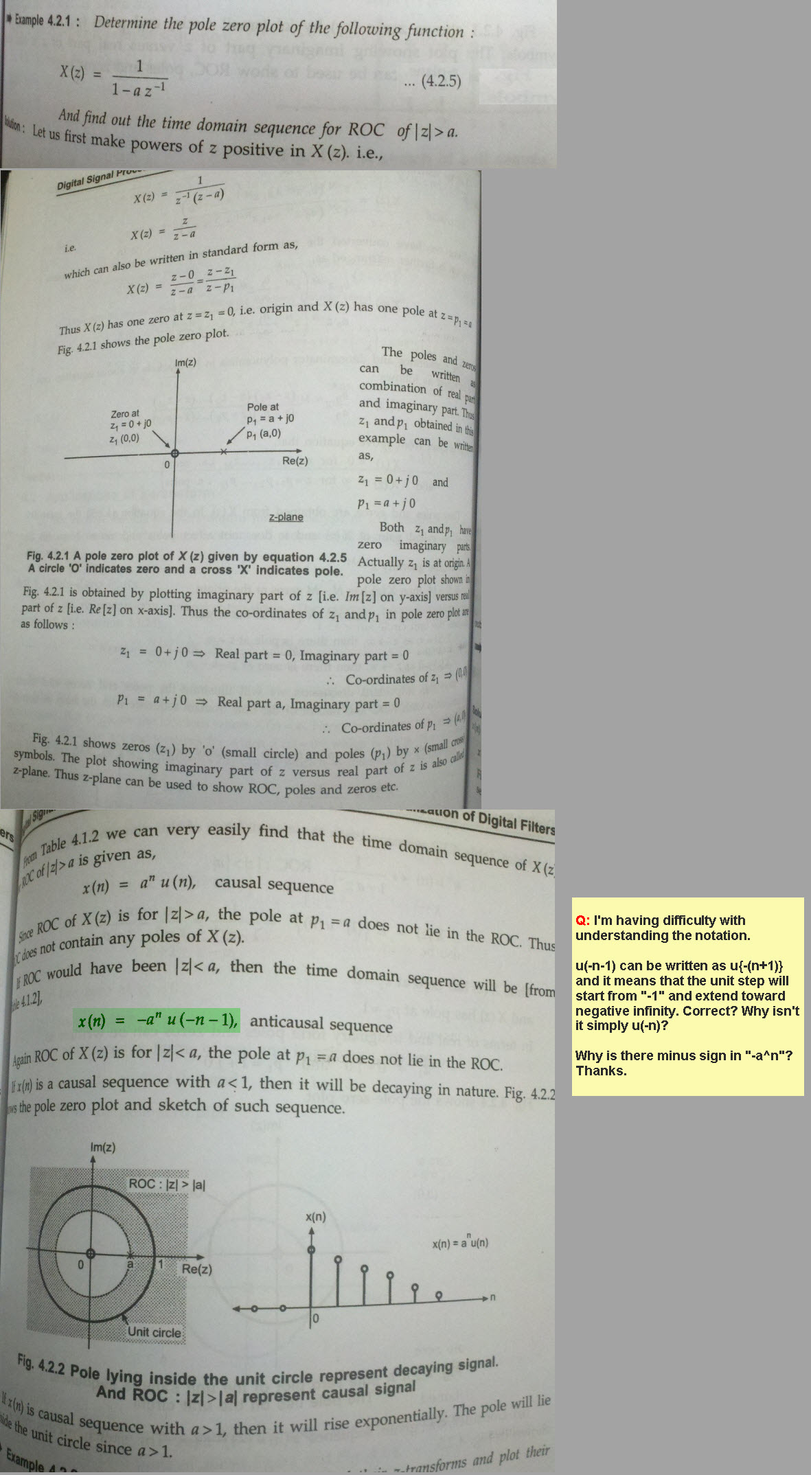

z-transform problems
Q1a I believe you are correct
Q1 (after part a) It seems to me different ways of saying the same thing, but I would have said it the same way as you did.

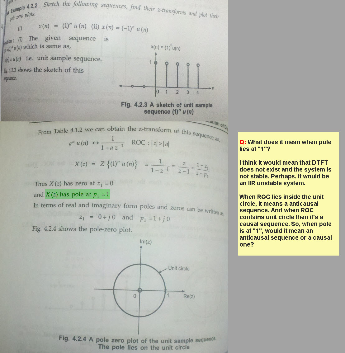

Q2
I don't see any reason why you can't use DTFT for IIR systems, if it exists for the system.
I believe you are correct that stable IIR systems will have a DTFT, for causal systems. In Q1 you noted an anti-causal system where the ROC did not include the unit circle, hence the DTFT does not exist in that case.
You use the terminology "handle" which is imprecise to me. The transforms do not handle the system. They only either exist or are undefined in certain cases. When they exist, we can used them and the engineer can "handle" the system. So in your question, for a causal system the DTFT can not "handle" the unstable IIR system because it does not exist in that case. The z-transform is in better position to "handle" this case because there still may be a region of convergence outside the unit circle. But, usually if the system is unstable, we can't really handle that system in practice.
DISCLAIMER: :) I hope I have these correct. I find the questions not so easy because I usually deal only with causal systems, and a lot of the answers to these questions might be different than our intuition would expect in the non-causal and anti-causal cases. Since 30 years has past since I studied this formally, i could easily give an answer that is correct for the causal case but not for the other cases.
Thanks a lot, Steve. It's really kind of you. And as far as I'm concerned, many a time I just need general understanding which doesn't need to be 100% correct.
Best wishes
PG
Hi
Could you please help me with these queries, Q1 and Q2? Thank you.
Regards
PG

To start, when i convert y=z/(1-z) to a difference equation i get:
y[n]=y[n-1]-x[n]
or:
y[n+1]=y[n]-x[n+1]
So it appears that the value of y[n+1] depends on the current value of y but also on a future value of x.
Q1: I'm still struggling with it. Please help me. Thank you.
Q2: So, when pole is located at z=1 then the system is marginally stable or unstable. In such a case when pole is at z=1, one needs to look at the difference equation to see if the system is causal or anticausal. Please correct me if I'm wrong. Thanks.
I found a reference which states that it is causal if and only if the unit sample response is zero for n<0.
Looking at the diagram it looks causal, so looking back at the difference equation:
y[n+1]=y[n]-x[n+1]
if x[n+1]=0, then y[n+1]=y[n] and that's causal, and might be considered a "DC" value. If we straighten out the circle top and bottom and extend it to y equals plus and minus infinity, we end up with a straight line at x=1 that extends to plus and minus infinity, and then if we shift that one unit to the left we then have the system mapped to the complex 's' plane, where the point is now at the origin (0,0), which indicates a DC value (which could be zero).
The only thing i dont like about this is that where did that first value of yn come from if there was never any input. A value of yn that suddenly appears without any xn input means it is not causal. The answer could be that it depends on the input but unfortunately i cant find any better reference.
Another reference states that if we convert the 'sequence' into an odd and even sequence, if we can recover the original sequence from the odd and even sequences then the system is causal, but if not then it is not causal. Unfortunately this reference is skimpy as well with little other information other than how to calculate the two sequences and how to reconstruct the original from them. It too requires a sequence but since we have the sequence in that text maybe this would help.
It's been so so long since i had to use any of this myself and some of the references are from the 70's.
I just wanted to add that in the real life situation we find out soon enough if it is causal or not. I had to ask myself why i didnt have to review this too deeply in the past, and i found the answer was that when we go to design a real life circuit the stability issue comes up and is more important because we must insure that the system is stable. Then once we have that established, we figure out an implementation and that leads to some real world values which may or may not be starting values, but they must come from somewhere. Where they come from would tell us right away if the system is causal or not because if we had to use memory of some kind to get the values or a startup algorithm for generating values then it cant be causal.
There was a really good example of this in the field of robotics but unfortunately i cant remember where it might be found after so many years. The idea though was that we would like to know what a particular robot movement WOULD do if we activated a given control mechanism in a particular way. If we knew this advanced information beforehand, we could get the robot to respond faster and more accurately. One implementation idea then might be to build up a table of possible outcomes and use that table to look up the resulting responses so we could just pick the response we want and simply apply the applicable excitation.
This system would require memory so that we could look up future values and use them in the calculation, and this differs from using derivatives to predict outcomes because the derivatives only *imply* what the outcome would be while the actual stored value would be an actual absolute outcome precalculated or measured from a careful pretesting procedure.
I hope this isnt too off track, but the main point was that in the real life situation we find out all too soon if we have a causal system or not.

Hi again,
Those two solutions can be found from a certain difference equation where we solve it differently for each solution (such as different initial conditions). Looking at the unit sample response for successive values of n we note a pattern and thus a formula emerges for each solution, and that's where for example the negative sign can come from. However, they did not show that information so perhaps they did not want to bother you with that detail for now. They may have just wanted you to refer to the Table 4.1.2, so perhaps you should post that table so we can take a look.
Q1 is kind of a weird question. First, you are correct about the unit step function starting at -1 and going in the negative direction. That's clear.
However, the other parts of the question are basically "why is this mathematical answer the answer?". Isn't that a strange thing to ask. Maybe you are asking if there is a typo in the answer given, which is always possible. I would say, either there is a typo, or if the answer is correct then it is correct because it is correct. If the answer turns out to be -a instead of +a, then that's the way it is. If the answer turns out to start at n=-1 instead of n=0, then that's the way it is.
So, is it a typo? I don't know because I didn't try to work it out. Maybe later I'll get a chance to check it.
So, I had a chance to check the calculations for Q1. The book is correct and there is no typo. To check, I simply applied the definition of X(z) to the cases given. If x[n]=a^n u[n], then X(z)=z/(z-a) for |z|>a. If x[n]=-a^n u[-n-1], then X(z)=z/(z-a) for |z|<a.
In you are curious, the transform of x[n]=a^n u[-n] is X(z)=a/(a-z) for |z|<a.

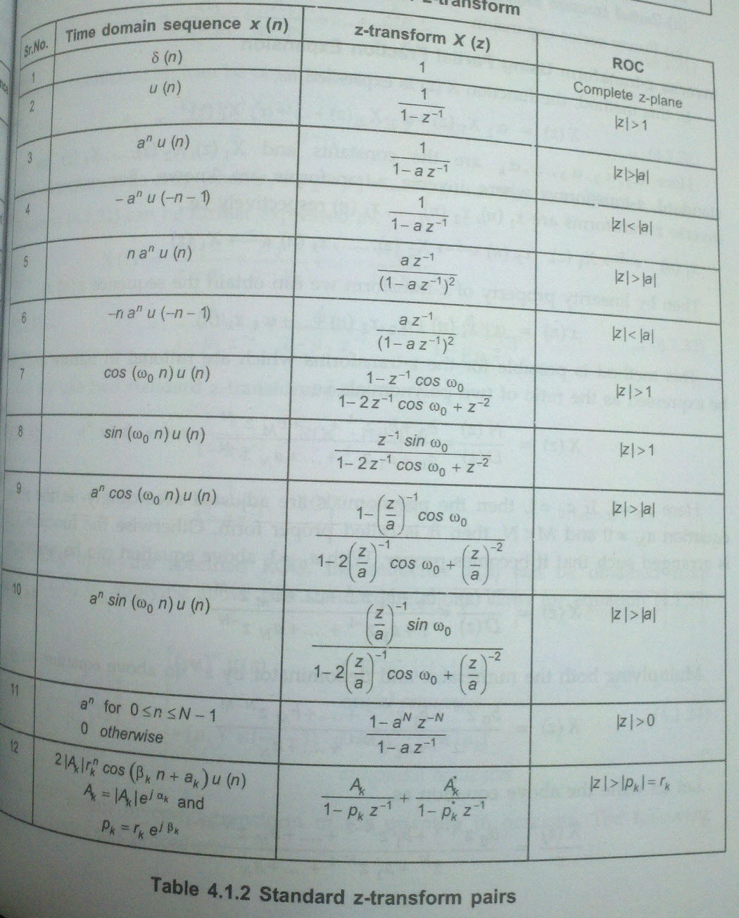

MrAl, I will try to post the table in next few hours. At the moment extremely busy! Thank you.
Regards
PG
Edit after several hours: Attached table. MrAl: I understand it now but you asked for the table so I have posted it. Thanks.
