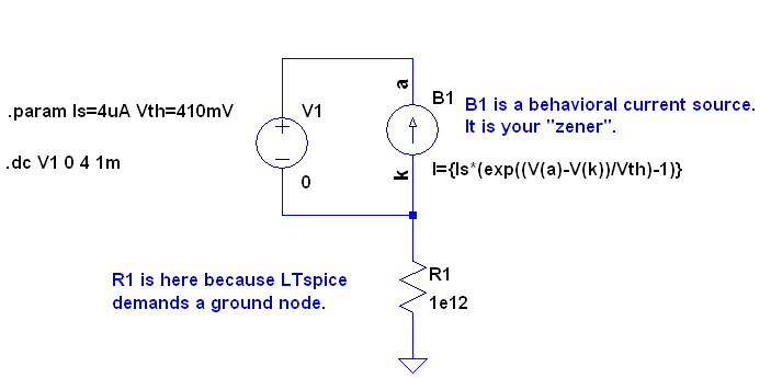

Hi all,
i'd like to create a zener diode with Vthr = 420 mV, Is = 4uA
and I(zener) = Is*(exp(V(zener)/Vth)-1)... i can't figure out how to do anything like this. I created a custom current soure that I thought obeyed these properties but it seems to output current constantly so that can't be right. Any thoughts on how to approach this?

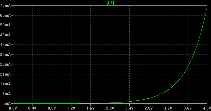

How about this:
  • behavioral zener.asc
