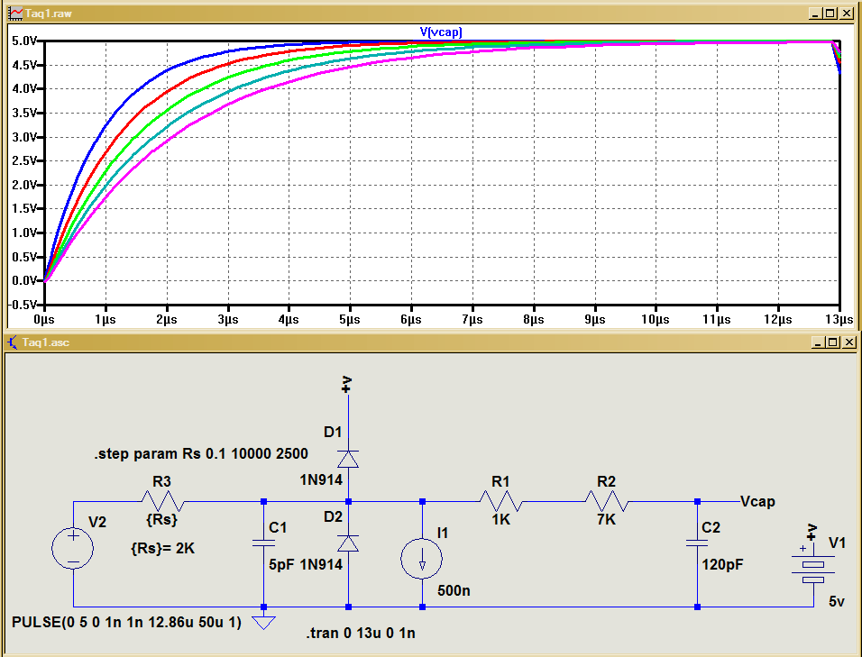

The PIC analog input expects a source impedance of less than 10K in order to run at its optimum rate.
If you examine the datasheet for the PIC it shows two clamp diodes on the input.
One connected to +V and the other to 0V, IIRC these diodes can sink 20mA, which means if you have a source resistance that limits the input current, to say 10mA, due an over voltage, these diodes will protect the PICs input.

I would also consider the R1||R2 combination as the total resistance.
What range of source impedance are you expecting.?
EDIT: this image is based on the PIC's datasheet,

hi Josh,
The matching impedances is not an issue with the PIC's analog input as its impedance is very high so it will impose a minimal load on a source impedance of ~ 10K.
The point you have to consider is the sampling rate of the analog signal when the source resistance is high, if you want optimum accuracy you must give the PIC's internal adc capacitor time to charge/discharge to the 'new' signal level.
If the sampling rate and acquisition time is long when using a higher than recommended source resistance, adding a small value capacitor from the adc pin to 0V will allow the charge on the small cap to charge the the internal capacitor.
In cases where the source resistance is very high a common method is to use a non inverting amplifier between the signal source and the adc pin.
A OPA [amplifier] has a very high input impedance a low output impedance.
