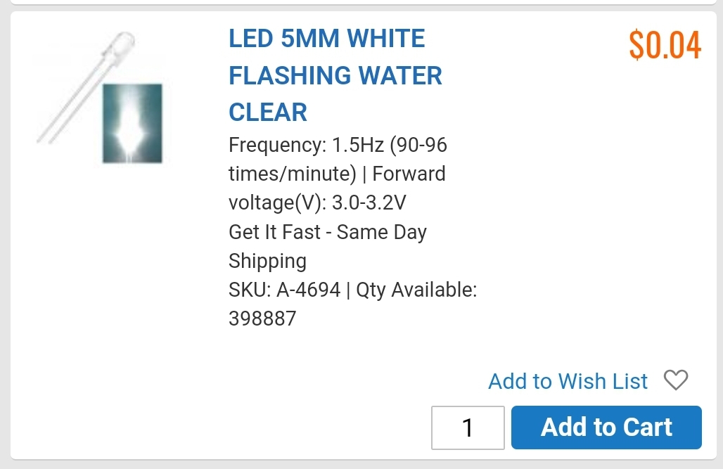

Just use a self-flashing LED. Battery. Power. Done. White self flashing LEDs are 4 cents at Tayda. Yellow are 3 cents, with the advantage of a lower Vf.

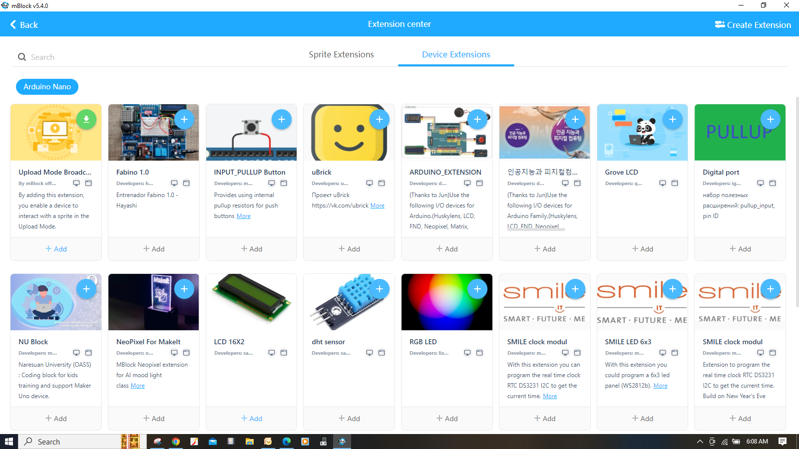

I downloaded the Mblock but it looks like all graphics.
I downloaded the windows version
Yes it is all graphic block IDE. It gens code as you construct blocks.
Then uses Arduino programmer to program board. You can of course use
its generated code in Arduino and further mod that in C/C++ should you so
choose. But once you do additional mods outside of mBlock you would have
to keep track of mods if you continue to use mBlock in further code development.
"Normally" one would not use that approach, just stay using mBlock.
If you want to program chip, eg. to use in actual proto, the ATTINY family, you can
use the board as an ISP for the chip.

Note mBlock has a rich library of extensions that can be added to its block
library (see below the add button at bottom
24 pages of these addons :
Note, depending ion extension, in Chrome browser you may have to set Windows security to
allow import of the extension. thats a one time setup.
Also some extensions board specific.
Also keep in mind many GUI IDEs like mBlock all with their own twists,. Like Snap4Arduino,
Tuniot (fastest way to bring up a server or client I know of), Scratch and its variants, Flowcode,
Visuino, Ardublock....NodeRed.....
Also ATTINY, many variants, down to 51 cents, but not sure how many can be used with
mBlock. I generally use a Nano or Uno board, then try programming a much smaller device
than what is on those boards, to see if it will handle the code generated in terms of memory, etc...
Regards, Dana.

after reading all the suggestions as well as post#27 as well as contemplating different ideas I might go with the flickering led as per post#27 but I need to research the LEDs at Tayda (I need 3mm not 5mm LED)
one solution is to put the 5mm LED in series with the 3mm led and now you have a flickering 3mm LED.
