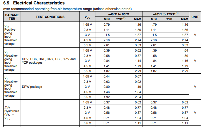

Ceramic caps will work fine here. But a coin cell is inadequate and adds a few hundred ohms. So your requirements are unclear. But using Schmitt 74LVC14 's are the simplest solution.
that looks tooo simple. will look ito it for the reindeer project
Belieeeeve it. Some logic gates have Schmitt Trigger inputs, which makes things very simple (though not super-stable). The technique was first published in 1936. Schmitt was studying the nervous system of a squid.
A 555 with reasonably decent parts around it will have better frequency stability, and the actual frequency will be closer to the calculated value. The issue with Schmitt Trigger gates is that the two transition voltage levels are not tightly controlled in production. This means tha for a given set of R and C, the actual frequency can vary with temperature, and from one chip to another. Nothing huge, maybe +/-10%, but a 555 comes in at around 2% (working from memory).
I like ST oscillators. I'm not a huge 555 fan, plus I often work with circuits that already need logic gates for other stuff. If there really is no need for the other gates in a package, then an 8-pin 555 is smaller than a 14-pin hex inverter of quad-NAND.
For really small size, Micrel(?) makes 555 derivatives that are missing a few pins. One is optimized for a monostable, and one is optimized for an oscillator. I think they are in a SOT-5 or -6 package.
For even smaller size, people make tiny CMOS logic components that have only one gate or inverter per package.

As tempting as the Schmidt is it has very large V and I suspect T
device to device variation. If this is a one off no problem. But for
a design with relatively accurate pulse rate.....doe not look good :
Look at Hysteresis values all over 2:1 kinds of variation. (at 1 specific power supply value), its ~4:1
over Vcc variation. Then throw in T variation on top of that.
Not only that we have problem with input leakage, creating huge offset thru 10M R......, the large R
used to facilitate small cap use. So to mitigate we need much smaller R, hence larger cap, meaning we
get large cap pile on T errors.
Regards, Dana.
My guess was +/-10%. Picking a set of values from the chart you posted comes in at +11% / -12% worst case, with no typical value given.
To evaluate this information in the context of this application, consult the Index Of Good-Enoughness.

And thats not including passive T effects.....and if you back into the trip levels worst case for the
min/max trip levels from hysteresis (crude approach) I think you are looking at 50% or more.
I looked for a good spice model for Schmidt, no luck so far, to run some monte carlo sims over
T and V to confirm my suspicions. Maybe just a quick heat gun and power supply test would
suffice.
The above came from me looking at a different vendor who did not spec the actual min / max trip
levels, just the min max hysteresis.
