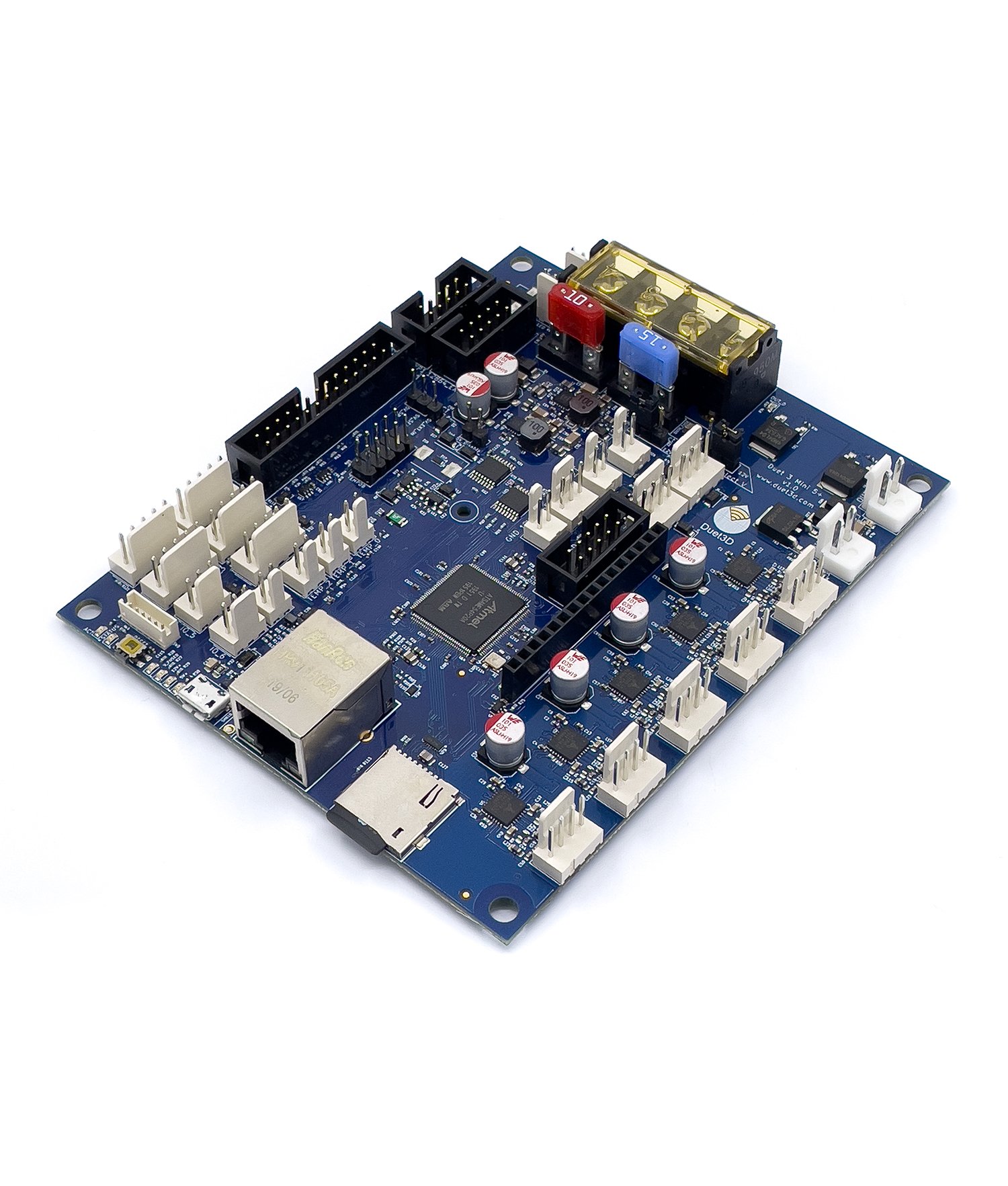

To be honest, the simplest option would be to use a Duet3 control board.
A "Mini 5" either Wifi or Ethernet should be suitable.
(Just the first link I found, not guaranteed to be the best price).
They will run stepper motors directly.
They can be configured by text files to match the arm mechanics, then positions and speeds can be commanded by XYZ positions in a sequence file or from a web page.
You can also connect an LCD or touchscreen interface for use within the machine.
They are intended for 3D printers but a lot of people use them for other types of machine and robots etc.
Plus they have an excellent support forum to help you with setup and any problems.

Hi and thank you.
I just see a little problem. My stepper motors are rated with a consumption of 2.0 Amp and the board has 2.0 Amp has Peak current.
The other point is it takes all fun out of the equation o_O because I also want to learn a bit about programming as I have done in the past.
Anyway, thanks and interesting solution.

OK, the Duet3 6HC would work in that case, but still the same type of setup. I've used a couple of those boards.
(I am also a programmer by profession, but I have too much on to take anything else other than at industrial rates, sorry).
