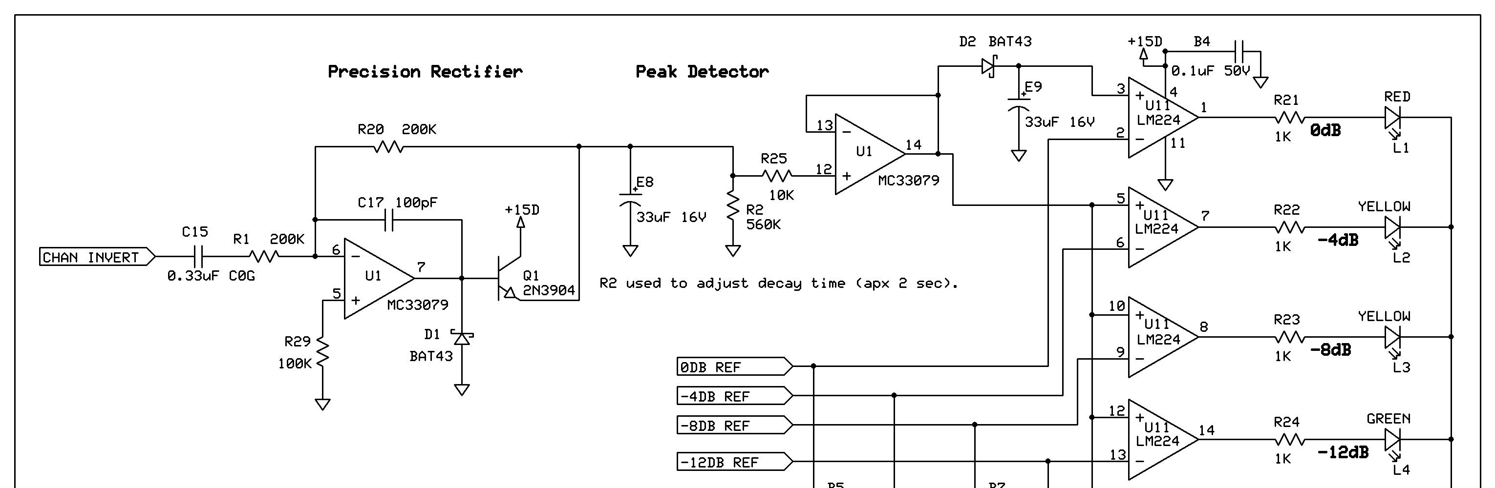

Precision Rectifier...what's going on here?
Why are you are using MANY parts instead of using an LM3915 bar graph IC? It drives 10 LEDs with regulated current as a bar or as a moving dot. It costs $3.89 at Digikey today and is still made in an old fashioned though-holes DIP package.
35 years ago I made a VU meter with two LM3915 ICs in series for a range of 60dB. 10 years ago I used one plus a level detector and a range of 50dB. I made a half-wave peak detector simpler than your complicated one that has many duplicated parts.
Here is my simple peak detector:

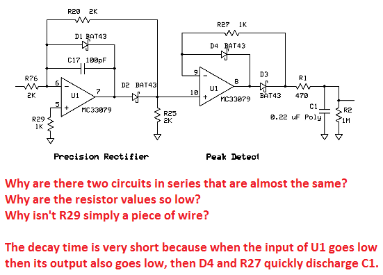

Why are there two circuits in series...
The schematic is a fluid document - I keep changing it as I evolve the idea. The first stage was once a full-wave rectifier, followed by a buffer amp to drive the capacitor.
I changed it to a 1/2 wave rectifier and now I guess it looks a little silly there. I then put in a rectifier on the 2nd stage buffer and the 2nd diode to keep it from going full negative (I'm looking for speed.
That is why the resistor values are pretty low.) R29 is used to improve thermal tracking of the op-amp. The general idea is to make it equal to the parallel inputs of the inverting input.
I see now that I put that last diode in, there is a negative "leak" that would drain the cap.
No question this still needs work! It will certainly be simplified by the time I'm done.

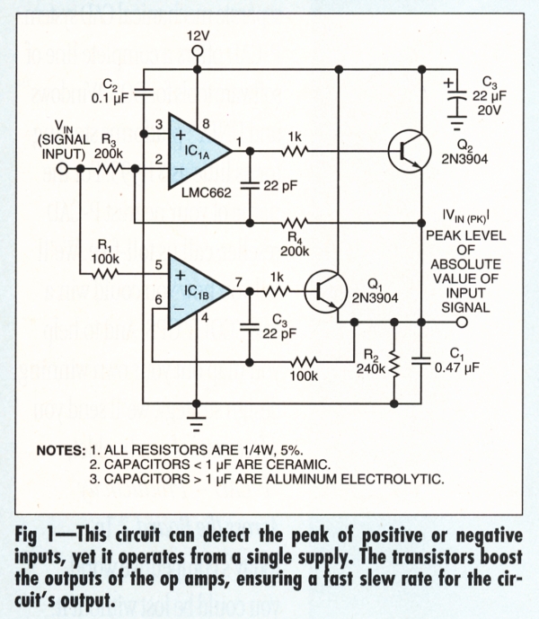

Thanks Guru! I like the idea of the transistor acting as the rectifier. I might just borrow this design. I saw a similar idea here:
As for why I am not using a bar driver chip: $3.89 each from Digi-Key X 16 channels and a few more prototypes = $78 plus shipping. I don't think Mouser even carries them - a sign that the part may be
hard to find in the future. I think I can do better than that. Two LM224 + One MC33079 = $1.36, saving me $2.53 each or apx $50 for all channels.
Sure, there's a few pennies in resistors and PCB space, but I'm not looking in that much detail right now.
One of my guiding principles of engineering is to make stuff work well and be as affordable as possible. I could buy a known-good 16 channel preamp for about $1000 or more, but where's the fun in that?
Cost is an issue. I'm putting most of the $$ into the audio-path capacitors and other important stuff. Power consumption is not an issue, and size/space is not an issue for this design.
If the inverting inputs to U1 were 2M ohms then without using 1M for R29 would produce an output error of 0.8V over a wide temperature range. But since the resistors are 1000 times less then the offset voltage with or without R29 is only 0.8mV which is nothing.

I'm taking your audioguru advice. I'm fiddling with it now, sacrificing speed a bit by using higher resistances to help the cap drain issue, looking into a transistor current source to drive the cap. Of course I nuked the extra stage.
I thought I'd look around for a higher speed transistor, only to find the very affordable 2N3904 is about as fast as you can get for pennies. Anything better is closer to a dollar.
I took the lowly '3904 for granted... didn't realize it was so fast!
I'd like to retain as much speed and accuracy at the lower (-40 to -60dB) range. If it works well enough I'd consider this design for a much higher resolution main meter. My "other" design option is to run all these signals into a $35 Arduino MEGA2560. There I can get a resolution of 12mV which just approaches -60dB, and plenty of options to drive many LEDs, but I don't think it would detect fast enough for fast, loud transients.
Yes, parts are cheap. However as an engineer I am always - always - trying to push the envelope in performance vs. cost. I don't want make another "me too" design. I often fail, but those few times I succeed, I get to add another point to my win column.
That schematic is from a design I did about 20 years ago. I still have the original, don't remember uploading it but I assume I must have published it at some point. I was working at National Semi and published all the app circuits that had NS parts in them, hence the crummy CMOS op amps.
As for:
"Thanks Guru! I like the idea of the transistor acting as the rectifier."
The transistors are not really rectifiers, they are included to give current gain to the output of the op amp. The reason is to give it a faster rise time charging the peak detector capacitor. The more current available, the faster the peak it can follow.

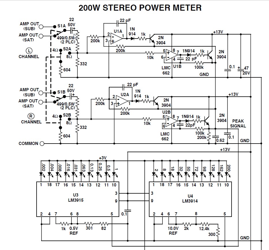

Here is the original design that circuit came from:

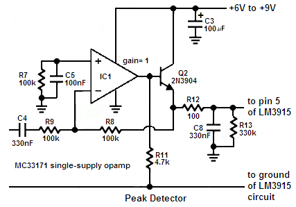

You can do it cheaper. I built a bar graph design back in about 1976 before the bar graph display chips existed and each 8 segment display was built up using a pair of cheap LM339 comparators and resistor dividers to set each inputs voltage point, you also need a reference voltage. Lots of parts, lots of hassle but it can be done. That antique is still running.....
If you want a cheap precision rectifier/peak detector that works well, this is one I did about 40 years ago that still works pretty well. Fast enough for audio work, all parts are cheap. Does require dual supply unlike the other one shown before.

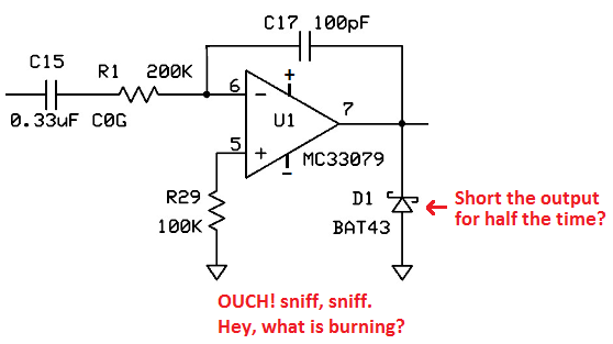

The emitter-base reverse voltage of the transistor will exceed its maximum allowed voltage of 6V for half the time or more which will slowly destroy it by avalanche breakdown. My circuit has a lower voltage single supply so the problem does not occur.
I do not like to see the output of U1 shorted by D1 for half the time.
Hmmm. That would be a problem.
I'm not too concerned about the op-amp because it is current limited, but if I remove the diode then the transistor gets cooked, and it might anyway.
Maybe if I put the transistor in a socket and keep a steady supply of them available it would work?
..well at least I have a long weekend to keep thinking about it.
